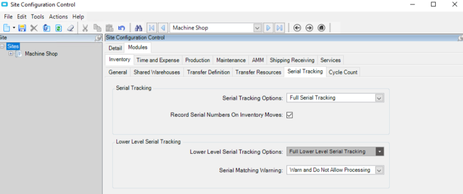

What are your site settings? (Site Configuration->Serial Tracking)
I’m guessing it’s the “Do not allow processing” option of the Lower Level Serial Tracking. Maybe try out a warning-only option in your Test environment?
Unfortunately, no. I switched that to ‘Warn but allow processing’ and still cannot issue a serialized part unless its original job is closed.
