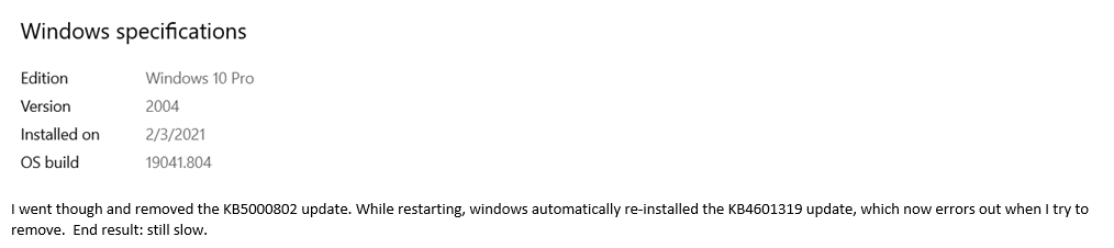

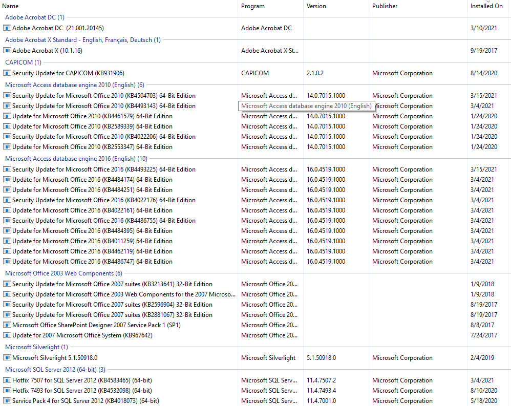

Anyways, I have another issue. This worked for one computer, but the other one doesn’t have any of these updates on it and is experiencing the same issue… Any thoughts on which one might be the issue?

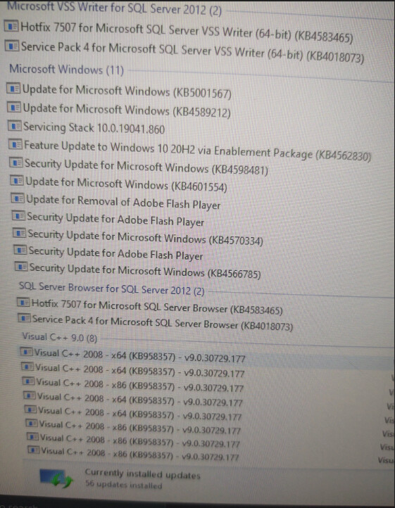

Without getting rid of some random security updates to see if there is now yet another culprit the only suggestion I have is stemming from an experience that ERPSysAdmin had in the other topic. They removed the KB4562830 which is the 20H2 Enablement Package and that helped their situation. I’m wondering if something is being included in that update.

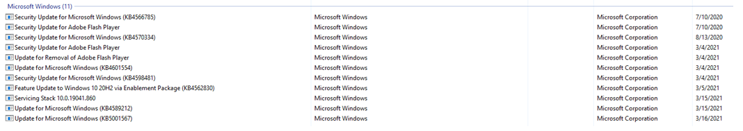

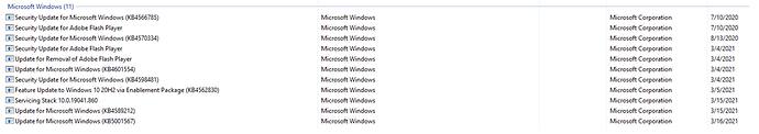

What’s the install date on that KB of that machine?

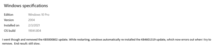

Yes that is what happens if both updates have been installed in sequence. When you remove March it rolls back to Feb Security update which is KB4601319 and you are required to remove that as well. I however have not had issues removing that update, but then again I removed it from all of my machines prior to KB5000802 coming out so I never had to do a back to back removal of both updates.
The only solution would be to try and remove KB4601319 via a PowerShell command and maybe it will remove that way, but if that is installed then yes Epicor will still be slow unfortunately.

It seems like when 20H2 is getting applied via that update pack in March it’s also degrading the performance of the machine. And to be honest, that install happening on March 5th post when KB4601319 was installed may explain why that’s no longer on the list of updates that you can remove. But once again I’m only guessing since I don’t have a similar situation here to test with.

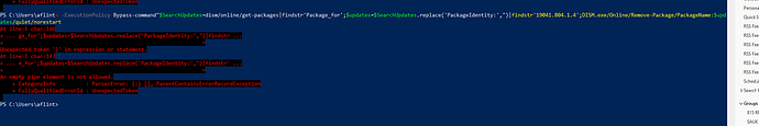

I believe to get that to work in powershell locally, just remove the powershell.exe at the beginning of the text. I have not tested that method myself though.

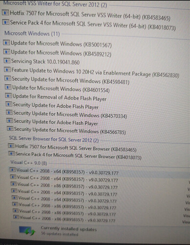

What does their machine now show for installed updates? As noted I never experienced this since my machines are all at 2004 right now, sorry that didn’t seem to help.
Also is their slowness the text book reaction to these updates? My experiences are unpatched a form will load in 1-3 seconds, it was taking 10-13 sec on a patched one as well as you would see the Open, Engineered and Released boxes light up well before there was any text in the form, and when closing the Job entry box it would hit a state of “Not Responding” before closing, which also took near 13-15 seconds to do.
I think I figured out the users issue. They haven’t updated to the 20H2 yet. I am hoping by updating to that it will install the updates, in which I can remove the problem ones.
Yes if there is anything pending install it will typically prevent removal of previous updates. I always do a reboot on a machine before trying to remove anything or modify installs, that insures it’s completed any pending operations.
Unfortunately I’m not able to help in troubleshooting that. As noted I got that script from another application and I’ve been using it through that, OR through PDQ Inventory using their “Run Command” function. Both of those methods send that as a CMD script to my knowledge (with that powershell.exe at the beginning to I’m assuming launch powershell), and they are both run using administrative credentials to do that. With you running it locally in PowerShell I can’t guarantee it working, sorry.
My only other suggestion is to launch a CMD window as an Administrator and paste the original script in there with the powershell.exe at the beginning. That’s all I’ve got.
Scratch that, its not working for me either… there must be something about this script that is not allowing it to be run interactively at the machine in question.
