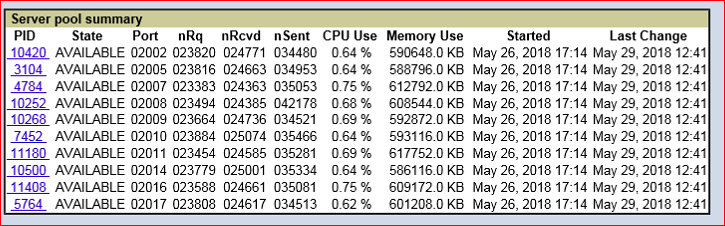

We used to have this kind of mystery a few years ago. ours was a problem with one appservers instance would lose the connection to the sql server and just be lost.
The rest were fine, so if your transaction happened to get assigned to the disconnected appservers if would throw an error and if not then would work fine.
We were using physical servers then and support wanted a cross over cable to directly connect the two servers to eliminate any networking issues.
In our case we noticed the Last Change column would not be current anymore and would click on the link and kill that appserver.
You may also find the 72xx error in the server log and kill that appserver. The P-010500 is the appserver 10500 above.
