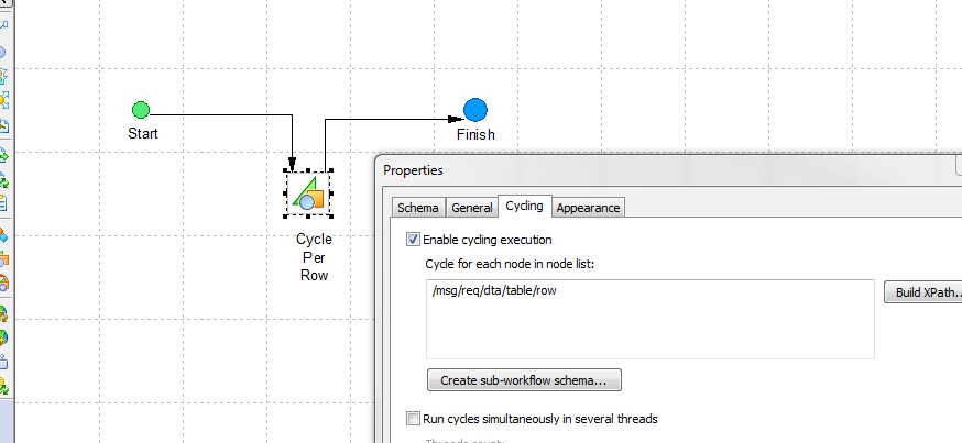

I’m cycling on a node from the top level workflow. I set up the sub workflow schema too.
When it enters the sub-workflow, it passes the data into parameters that are used to execute a stored procedure.

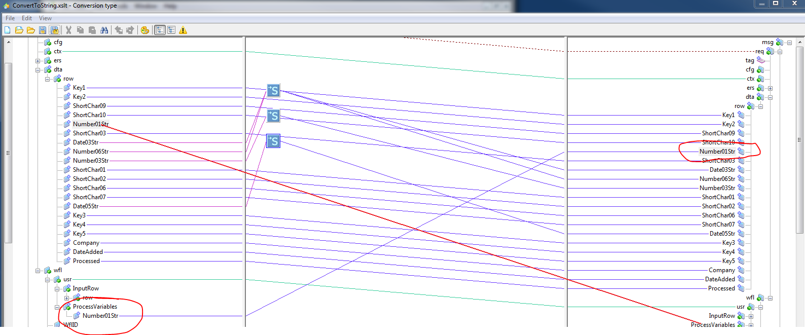

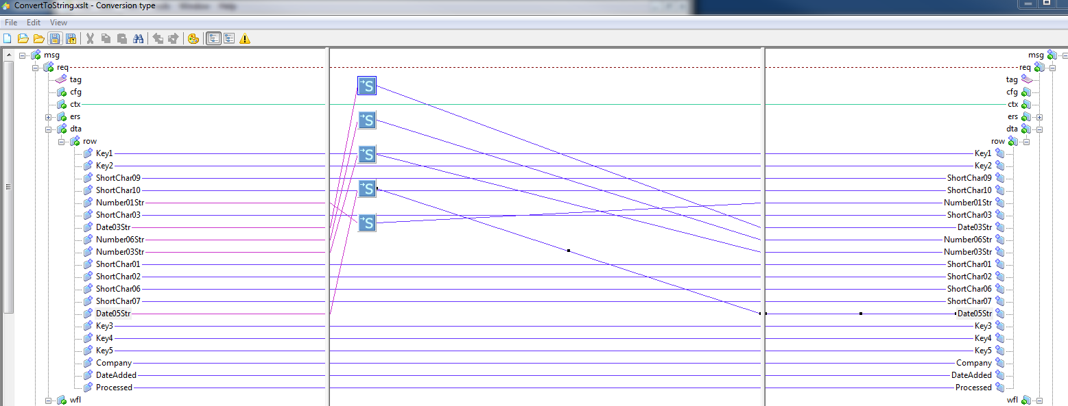

  2. Can you post a screenshot of the sub-workflow using the conversions?
Here’s the sub workflow conversion

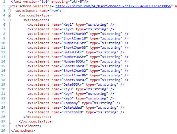

Can you post a screenshot of the schema detail?
Can you make a test mapping the functions to a string process variables, instead to mapping to the schema fields?
subworkflow schema:
Mapped process variable into function:
Saved, and ran the workflow and the result was the same.

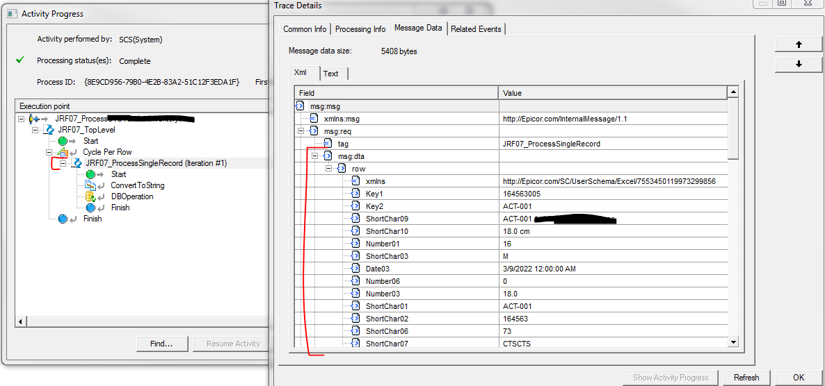

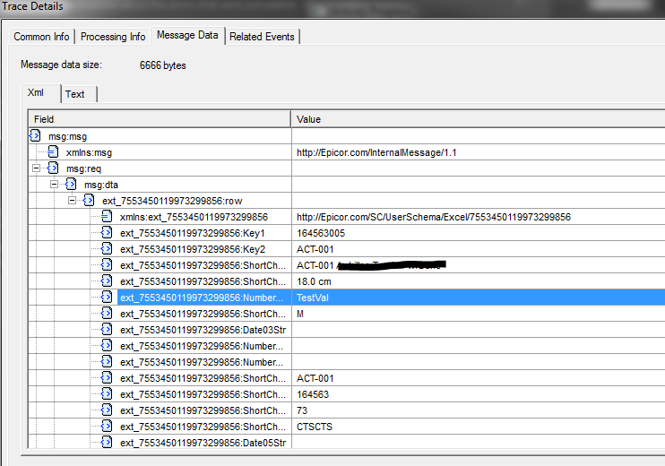

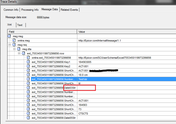

Here’s an interesting thing. On the document trace, during the conversion step, the data does something weird:
It looks like it was set to my Number01Str was set by my process variable, but you can see that the rest of the non-string values have been dropped at this step.

Can you make a test using the mapping in this way?, from the Number01str to the variable and check the trace

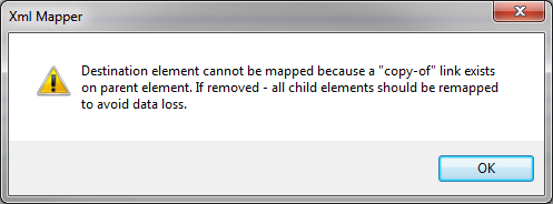

I attempted that but I get this message:
My top level schema is different than my sub workflow schema. On the top level, I have a multiple-row type schema but in the sub workflow, it is defined as a row-only type.
I’m tired :slight_smile: I re-mapped it like you specified, but the result is identical.
