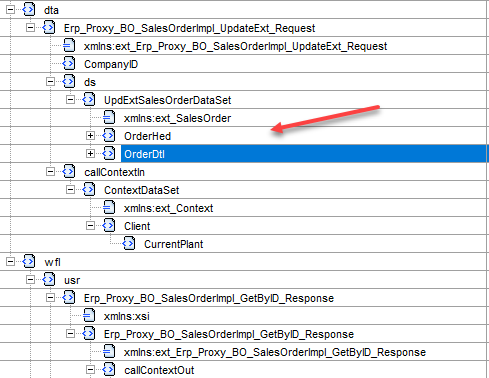

Interestingly when I look at the request for the UpdateExt I only see the following for the dataset which is a bit odd. I’m thinking I might delete the conversion and do it again.

Whew ! rebuilding the workflow fixed it. One of the Conversions had a request and response schema in the right hand side!

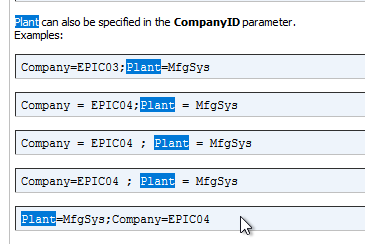

Yes I’ve had issues with multisite as well but have found setting the syntax on the CompanyID parameter usually fixes it in Service connect:
I actually did see that in the documentation and tried it. I couldn’t get it to function, but that should definitely be a way, just using a functoid to concatenate the string with the plant on the end…If I get time I might look at it, in more detail, what my thought is that the using the update_ext was only looking at the first release in the order dataset and not the newly created one, which explains why doing it in a subworkflow worked…I guess, but i could be wrong…
