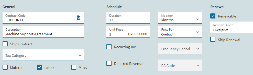

Hi all, I’m trying to get my head around service contracts. We offer a few different contracts for machine and software support to our customers with various pricing options. I created different service contract codes for each, set the prices. eg:
But unless I add some parts to the line items, AR Contract Invoicing does not generate invoices. And if add parts as line items to the contract, its using the part pricing not the contract pricing when the invoice is generated.
So what’s the unit price in the contract code for?

the help tells you, it should use the contract price, however, the screen has other ideas, this would appear to be a bug and will need escalating to Epicor.
However, it would be fairly easy to write a BPM to update the contract price.
