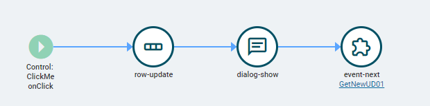

In several events I’ve tried setting this in a row update where the binding is:
CallContextBpmData.ShortChar01
and the value is:
“SMRM”

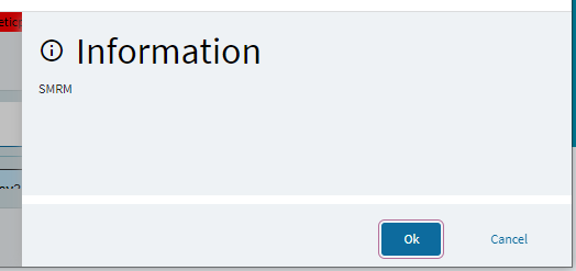

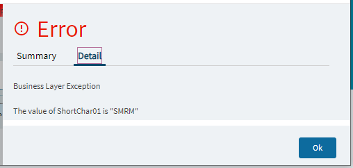

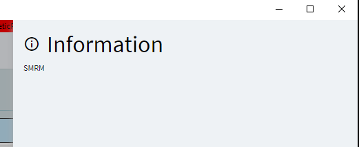

When I add in a dialog box, I see the value is set locally, but when the directive fires there, the data is not set at that point. I’ve added a SysUpdate event, but nothing changes.
Is there a magic word to update the call context view in the Kinetic layer so the directive can see it?
I was setting the context data field when the form loaded, but evidently the values don’t persist during operations. I changed it to set the value before the GetNew event and all is well.
