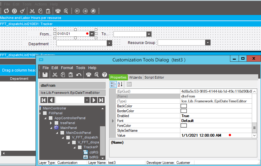

I created the Form… field in Dashboard tracker view which has Epibinding with a field from query (JobOper. OpStart). I can set a static value as default through customization and user can choose different date from the calendar. Let me know if I am getting what you are asking. @utaylor
Yeah you are getting at what I am asking. I was wondering if you could set that to a field from your query… it looks like you can’t. If you could I was going to suggest you make a calculated field in your query that calculates 60 days back from today and then you could plug that field into the value field for the default field that you are showing me.
I got your point, Utah. It would be great if I could choose the field as the default value, but you can only put a static value there. Anyway, thanks for your prompt response.

We have done this with dashboards setting a value like
epiDateTimeEditorSnap.Value = DateTime.Now.AddDays(-1);
in the InitializeCustomCode procedure. You could use -60 if you wanted it to be 60 days, in my example, I was using yesterday’s date. You could use a customization to do it, but this was just in Customize Tracker View.
Beautiful!
THANK YOU! It did work! Awesome!
