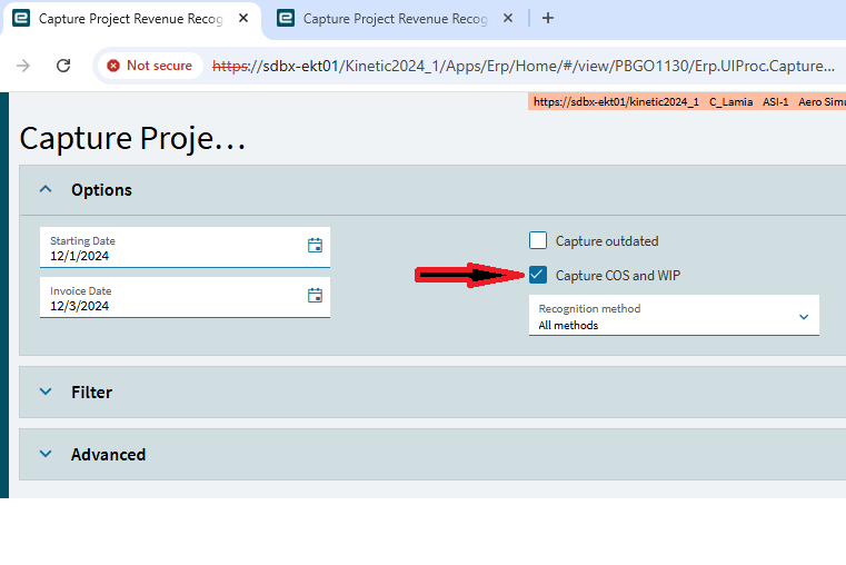

I am trying to set the default value of the Capture COS and WIP checkbox in options of Capture Project Revenue Recognition. I cannot find any documentation on how to do this. Any help is greatly appreciated.

However, below is how you can set this up for your case:
Go to overflow menu for “Capture Project Revenue Recognition”, select Application Studio, name your Layer.
Navigate to Data Rule, Name the rule and set the field to TRUE. See below:

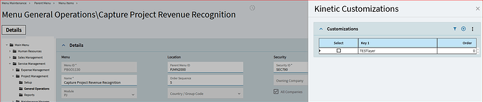

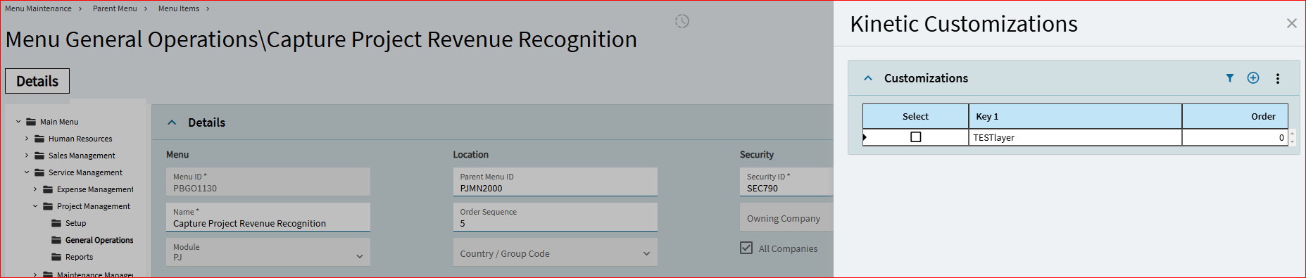

Once done hit on save, commit and publish the layer on top right corner.
And then navigate to menu maintenance, add your layer there, and upon re-logging in, you will see this change for all users.

Thank you for your amazing help!!! Turns out I created this data rule and did not publish the layer…missed an important step. I guess I just looked at it too long and missed basic steps. I went through your video tutorial and it worked great. I was able to get the results I needed.
THANK YOU!!

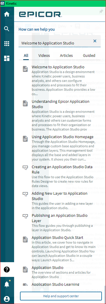

These documents are available on EpicWeb (check with your system administrator for access):
App Studio User Guide
App Studio Fundamentals User Guide
App Studio Extensions User Guide
App Studio Reference User Guide
