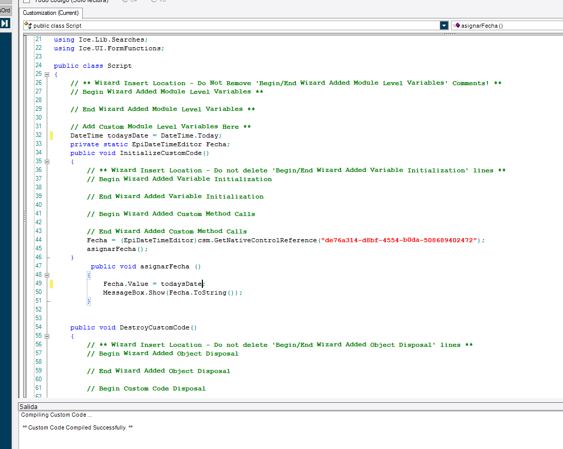

In a customization I need to set a EpiDateTimeEditor to todays date, this is what I have so far.
When I put a Messabox.show it only prints out: “Ice.Lib.Framework.EpiDateTimeEditor”
This is the code I’m using:
Any ideas?
Have you tried Fecha.Value.ToString() ?

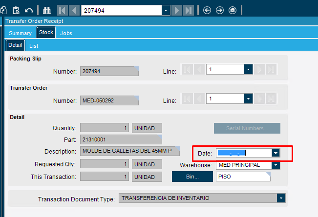

Yeah, we had a problem and need this date not to be changed by the user and has to be set to the day that the user opens an order transfer
Yeah it still throws out the message: Ice.Lib.Framework.EpiDateTimeEditor
Which version are you on? It seems to work for me:

Using this, it works, but I select a transfer order and go in the stock tab to select the Date, it’s still empty
This is the Date that need to be filled with today’s date.
I see what you mean. I may have misunderstood what you were trying to do. I think since it’s a native control, you’ll have to change the DataView rather than the control like @hmwillett was saying.
If you look at that date box’s properties, you’ll see it’s bound to a certain field for a certain dataview. You’ll have to modify that field, and it will update the text box automagically.
