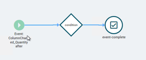

In our case, we were doing this in pack out entry. When we pack and unpack, we want the focus to return to the part number field after they enter the quantity. To do this, we created an event that triggers after ColumnChanged_Quantity. In the event we added a condition object, and then added an event complete.
For the condition expression we had the system evaluate a setTimeout method after a half a second (500 milliseconds). The function executed gets the reference to particular control (txtPartNum2 in our case), and then gets the reference to the input element and sets the focus to the input element. Here is our condition expression:
eval(“setTimeout(function(){this.document.getElementById(‘txtPartNum2’).getElementsByTagName(‘input’)[0].focus()},500)”)
The setTimeout was the key for us. We could get other events to fire, but they were all firing too quickly to set the focus.

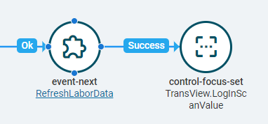

Did you attempt the control-focus-set? Was the timing the issue on why this approach didn’t work?
We use it in events to set the focus as the final step:
Yes, we tried that first. We tried it up and down the event chain, even all the way to the very last event that is run. Still didn’t work for us.
Curious… did you use the “on success” type connector like in the above image? Just wondering if that may have been why there were timing issues, it wasn’t waiting for the previous event to be “successful” before changing focus.
Dunno… again, just curious.
When we were trying this without a condition, the control focus set was the only object in the event besides the trigger. The event trigger was after the last event in the chain. There wasn’t an option to mark the connector as “on success” when it was coming from the trigger. The condition is only in there because it allows me to perform javascript which allows me to perform the delay.
