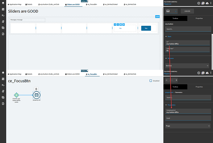

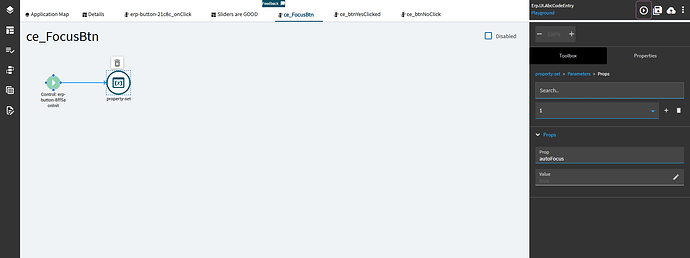

Got it.
You’ll have to put your own buttons on the slider instead of using the page button, but then you can create an event that fires on the “No” button’s OnCreate event and call the property-set:
Brilliant! Thanks!
