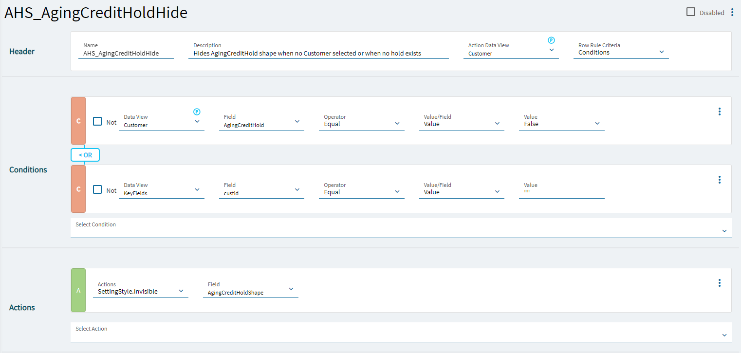

I’ve done this with shapes - and I’m fixing to do it with textboxes and combos here in the next few days.
It takes just the Hide conditions and then appears when those conditions are not met:
So, I tried starting with the combo hidden. When I test it, the combo box does not appear. I unhide the combo and was testing something else, and when I selected the value, the combo became hidden!!
It does not appear that the Row Rule will unhide it.
Does this seem like a bug I should report? Or is it operating as designed?
Ugh
That is what I’m seeing now that I’m trying with textboxes.
It continues to work fine on my Shapes…
I thought at first that maybe it was because the EpBinding of the shapes is a virtual field (AgingCreditHoldShape) - but when I try that with textbox EpBinding, it makes no difference
