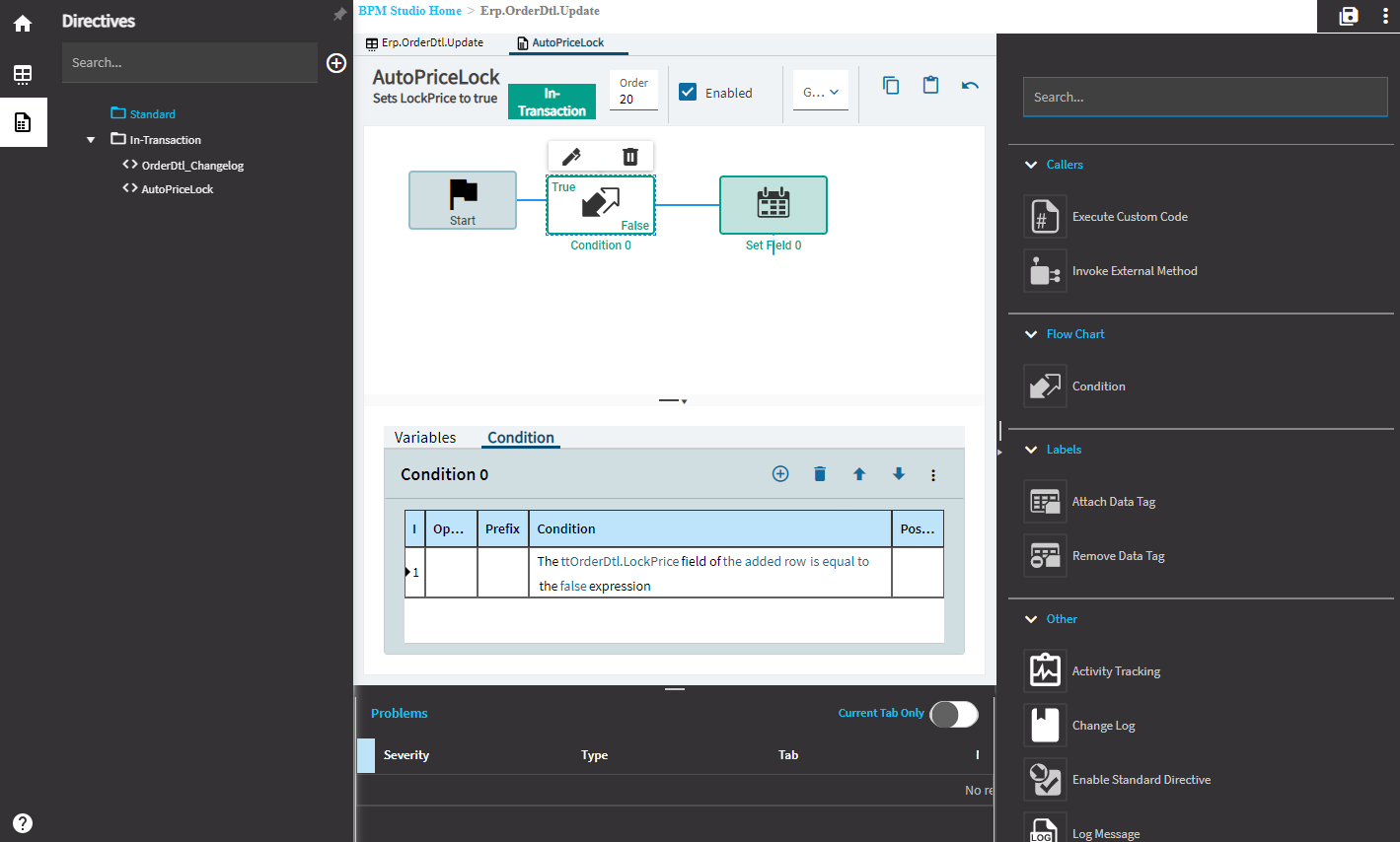

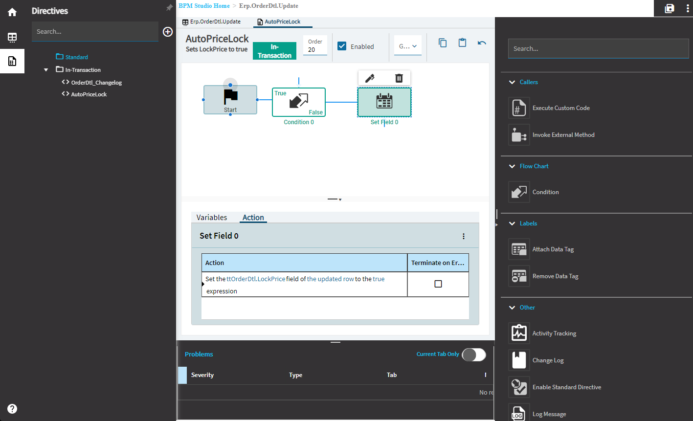

When that did not work, I went to data directives. I created the following BPM, but this does nothing at all. As shown in the screenshots below, I made a condition to check if the added row of OrderDtl.LockPrice is false, then change it to true. I made sure to try both added and updated row for both the widgets in the BPM, and nothing worked. Any idea what could be wrong with this?

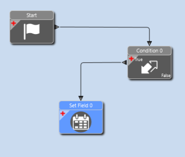

I think you have it using your Data Directive… but you’re coming off of your condition on the wrong side.
Condition is checking if the checkbox value is “false”.
If that condition is TRUE (the checkbox value IS “false”)… then change it to “true”.
Right now, you’re checking if it is false… which it is… but your set field appears to be coming off of the “false” side of the condition.
Move your Set Field to the “true” side of the condition.
Wow this was it! I never realized that it mattered where you put the connectors, guess I was lucky when creating BPMs before. Thank you for your help!
It seems like you’re looking to have the “Lock Price” field set to true automatically when a new line is created, but still want to have the option to toggle it later if needed.
In this case, it will be easy to use Method Directive. There is a method called “GetNewOrderDtl” under SalesOrder Business Object. Use post-processing for this and directly use set field widget to assign value to true. With that, you won’t need any condition as well.
@dcamlin’s solution is great too !
Yup, that’s how you tell it to do specific things based on the condition results.
If the condition evaluates to TRUE… continue the process down the path on the left.
If the condition evaluates to FALSE… continue the process down the path on the right.
