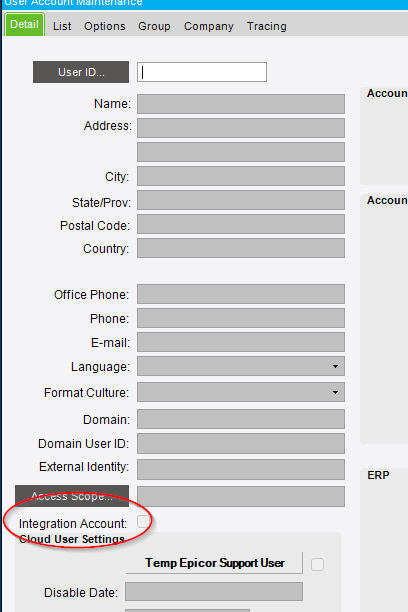

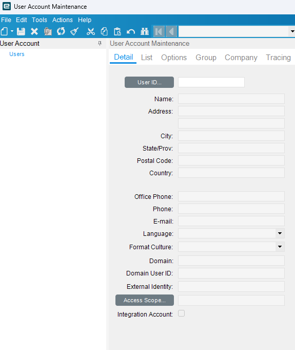

on what tab is that via smart client?
Just noticed you are on 2021, not sure if it existed back then.
Yes, it is.

Hmm, there seems to be another way that doesnt require integration account and set the password expire date to blank.
Why don’t you want to use an integration account?
Setting the “Password Expires Days” to zero (0) will set a user password to never expire… but no clue if/how that impacts integration accounts.
I think there was a change where Access Scope could only be applied to Integration Accounts, but I could be wrong on that. EDIT: If you apply an Access Scope, it will automatically set it to an Integration Account.
Separately, I find the setting useful during audits to know that the account is used by machines and not people. It makes the auditing better. :person_shrugging:
Access Scope is an excellent tool for limiting the access of an account and I’d encourage its use for limiting risk.
