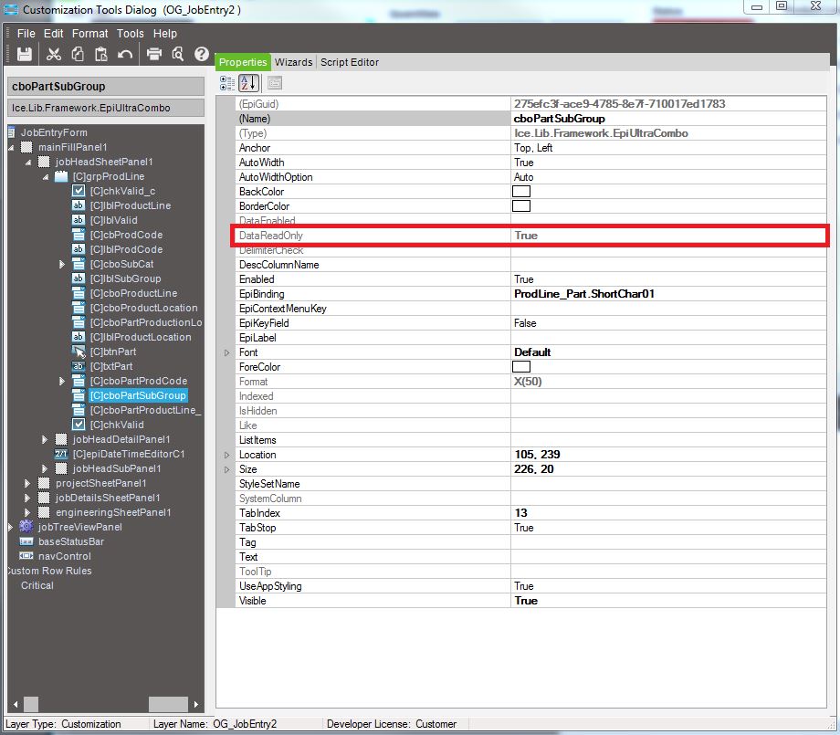

Thanks for the quick feedback. One thing I forgot to mention is that the users want the flexibility to modify the text field that’s being copied over. I’ve tried the Foreign Key View, but the fields are defaulted to DataReadOnly “True” with no options to change to false.

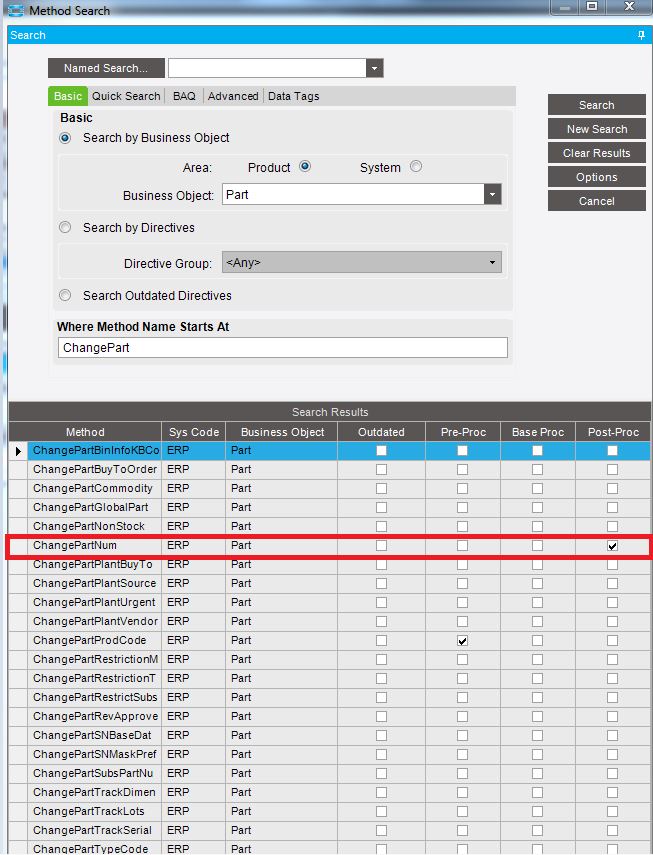

Jose,
I wasn’t able to locate ChangePartNumMaster method in Part, but there was a ChangePartNum. I’m not sure if that’s what you’re referring to, but I went ahead with that method, the problem is it doesn’t have an option to set the ttOrderDtl table.
You are referencing the wrong Business Object, you should use SalesOrder.ChangePartNumMaster

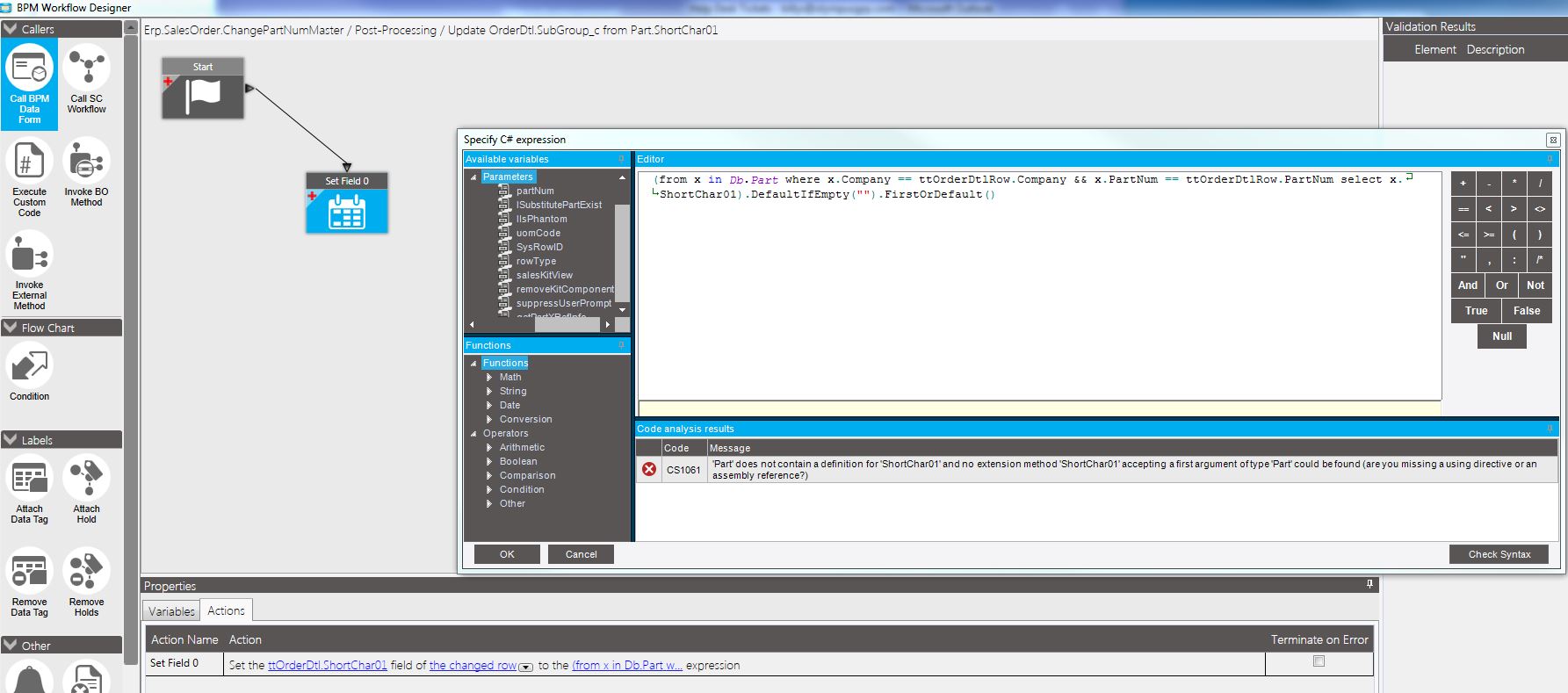

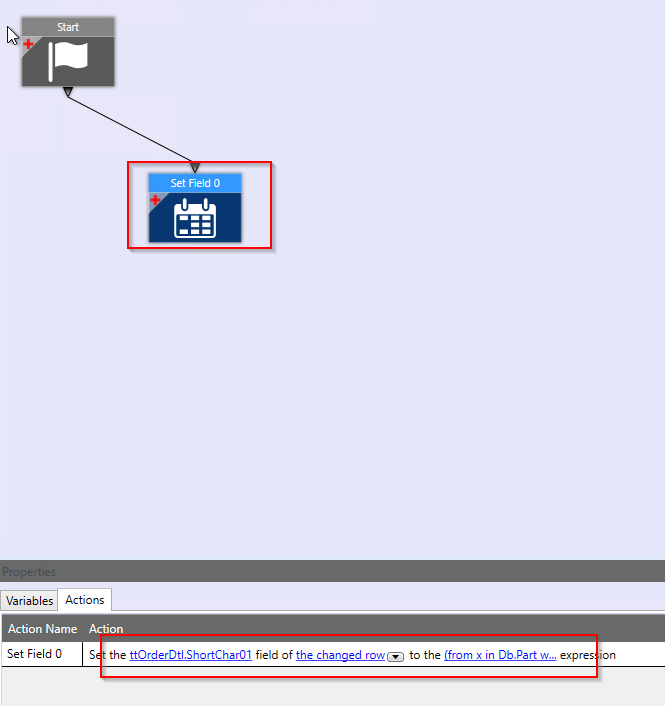

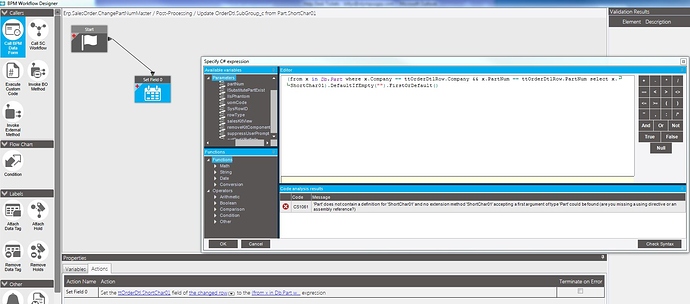

Hey Jose,
This may be a simple brain fart from my end, but using your code, I keep running into the error below.
System.Drawing.Bitmap CS1061 ‘Part’ does not contain a definition for ‘ShortChar01’ and no extension method ‘ShortChar01’ accepting a first argument of type ‘Part’ could be found (are you missing a using directive or an assembly reference?)
Try lowercase Shortchar01 it is case sensitive… it should auto complete for you if you hit Alt Space
I am having the same error and I tried with no success:
(from x in Db.Part where x.Company == ttOrderDtlRow.Company && x.PartNum == ttOrderDtlRow.PartNum select x.ShortChar01).DefaultIfEmpty("").FirstOrDefault()
(from x in Db.Part where x.Company == ttOrderDtlRow.Company && x.PartNum == ttOrderDtlRow.PartNum select x.Shortchar01).DefaultIfEmpty("").FirstOrDefault()
