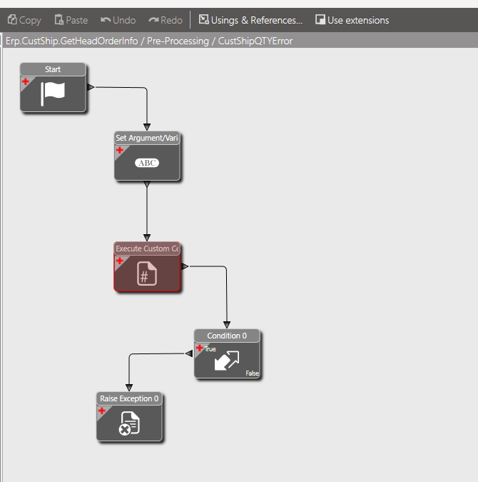

I am trying to set a bool variable from a BMP. It is a pre-Processing on CustShip.GetHeadOrderInfo.
I am trying to pull it from a calculated field that i created in a BAQ.
I started by setting a variable to equal the packnum.
but i cannot get the correct syntax for pulling back the value from my calculated field. (it is called Error). Here is the custom code i am trying to do it from.

I get error "No Overload for method ToString takes 1 arguments
Try PackID.ToString(). Or something like that. The error is saying that you have too many parameters in the ToString function.
I am going to have to put you on the payroll LOL Thank you. I knew it was an easy problem.
