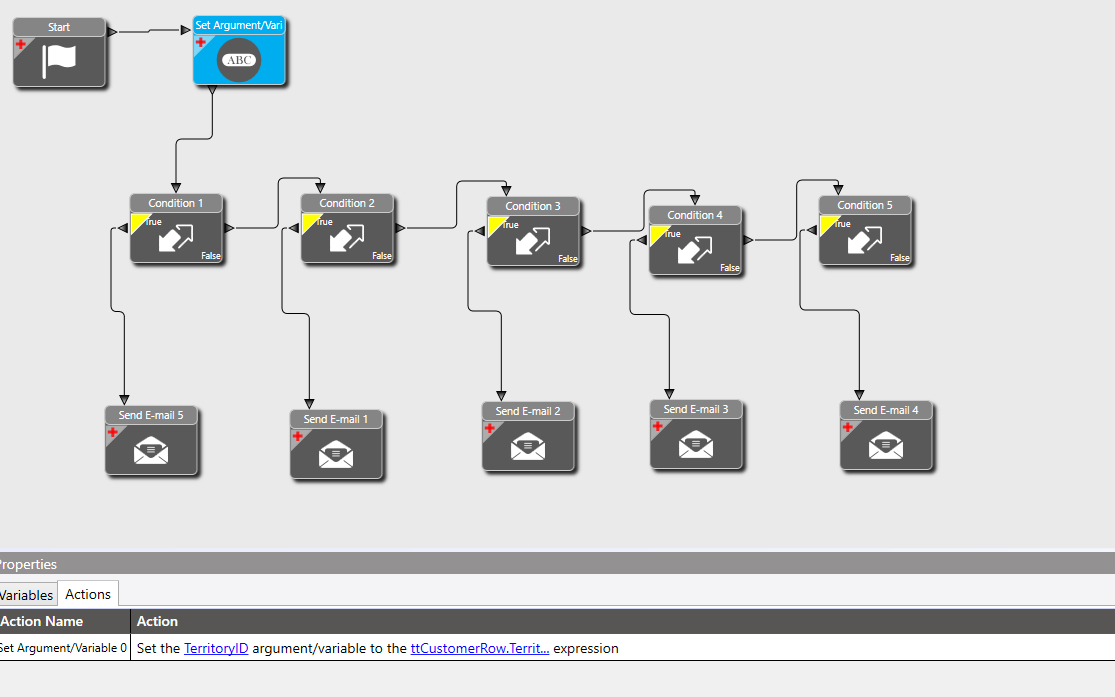

I have something like this setup:
Where I set a variable to ttCustomerRow.TerritoryID and have it setup so that it sends out an email to each sales rep letting them know that a new customer is added within their region. However when testing this, nothing fires. I have this setup as a Method Directive under Post-Processing. Any clue to what I may be doing wrong?
Usually when a new customer is added - the territory is also filled out as well. Would this still not be in Customer.GetNewCustomer?
If the Territory is initially blank and then the user selects one, then the Territory field in the Customer.GetNewCustomer post processing dataset would also be blank.
That said, I’m not sure if there is some sort of CRM config setting that may be adding default territories to new customers.

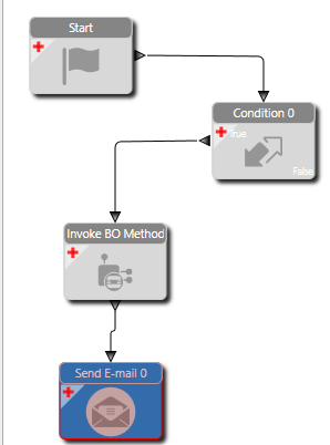

Not knowing how your Customer creation process is set up makes it a little difficult, but I would do something like this.
- Create a Standard Data Directive on Customer
- Have the first widget be a Condition to check for whatever you want to check for
- Next widget would be Invoke BO Method to Get By ID on SalesRep BO
- Last have a Send E-mail widget that uses the returned dataset to fill in the email address, name, etc in the email
If none of the automated row selectors are returning the correct data, you can try changing the first widget to a c# block with the following code:
var ttCustomer_xRow = ttCustomer.Where(x => x.Added()).FirstOrDefault();
TerritoryID = ttCustomer_xRow.TerritoryID;
