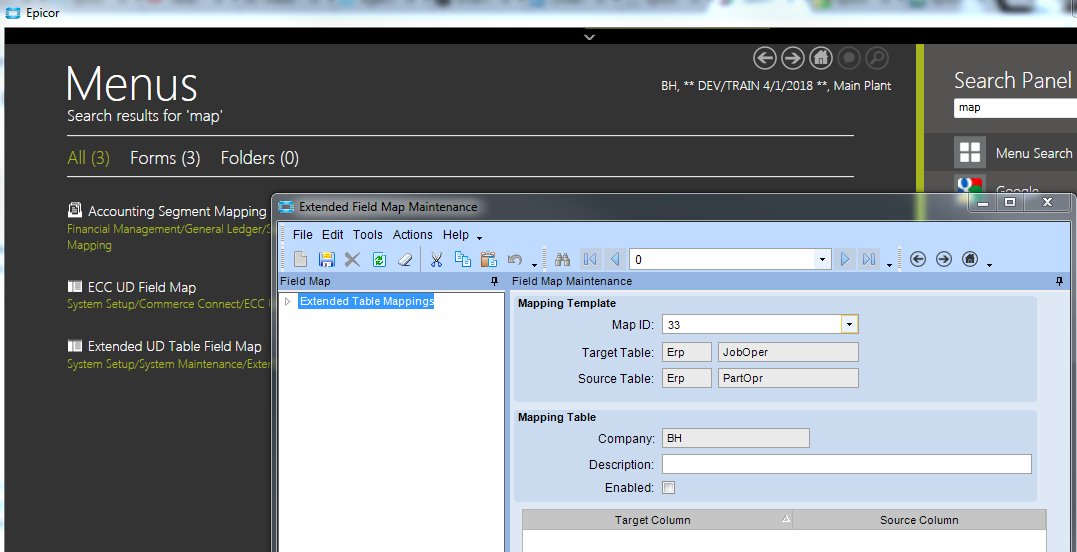

Garrison, remember that there is a UD field mapping tool which sometimes, not always, can simplify this passing of UD fields from one entity to another for you. It could reduce the need for doing it in BPMs.
Best,
…Monty.
Mind blown. Had no idea that existed. Thank you so much for bringing it to my attention Monty!
