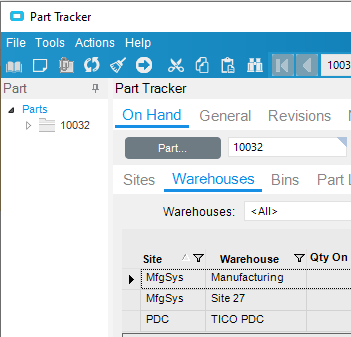

  3. If you have multiple, there are a dozen ways to figure it out. For example, Part Tracker (pic below). Or a BAQ. Or if you access to Site Maintenance, you could see a list.
