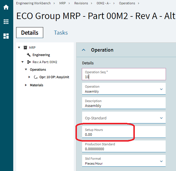

When you are creating methods in the Engineering Workbench, at the Operation level the Setup time for the operation goes in this field:
