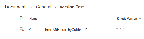

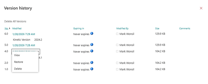

First of all, yes, if you a have a document in the library:

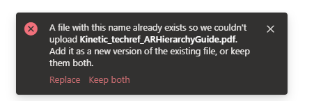

And you upload a file with the same name, you will get this prompt:
If you say Replace, it will automatically save a new version.

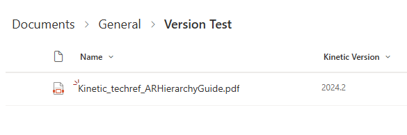

(I’ve added meta data for the Kinetic version. Any changes to the record and not just the attached document will also create a new version record.

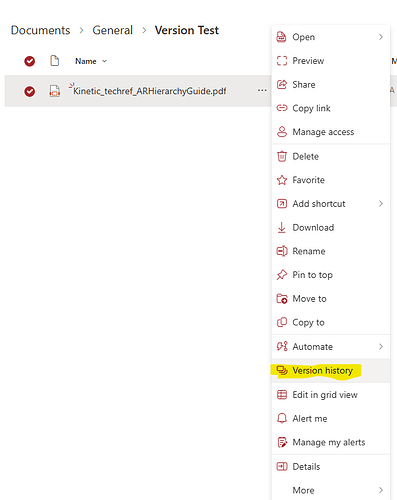

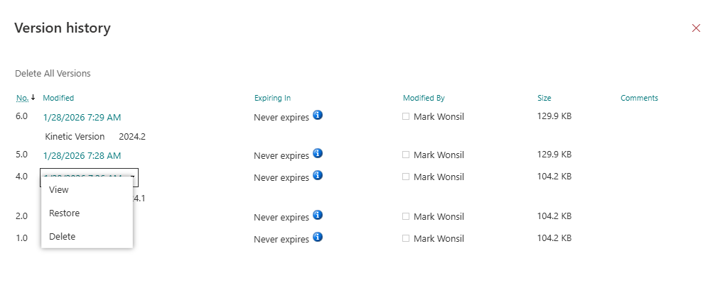

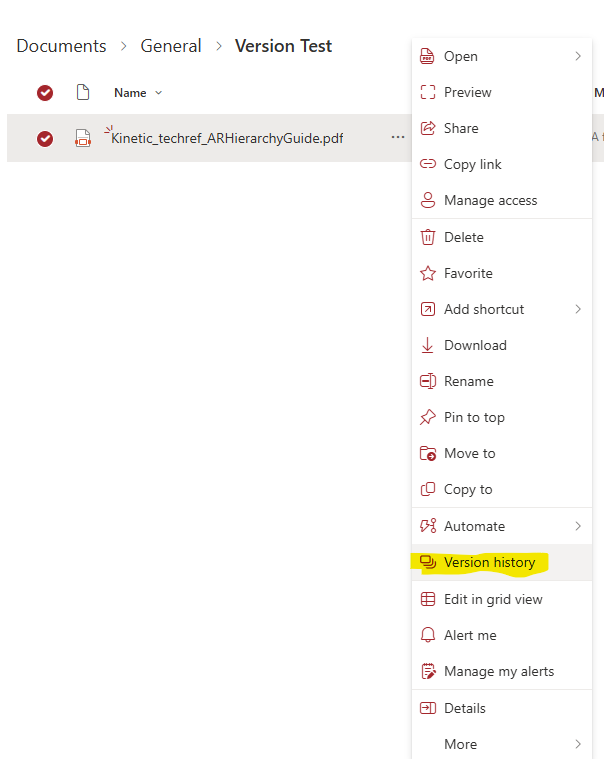

Note you can View, Restore, or Delete individual versions under the same file name. No more final, final-final, etc.
