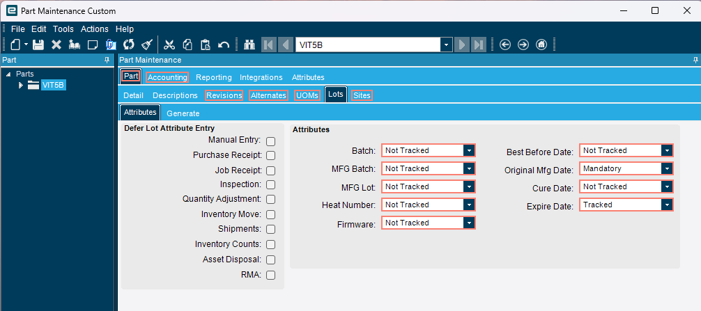

We are using lot tracking on some parts and have marked those with the manufacturing date as mandatory and the expiration date as tracked. I seem to have wrongly assumed the system would take the shelf life for the part, add it to the manufactured date and fill in the expiration date. What would be the best method to accomplish this if possible? If I create a BAQ to calculate the date, is there a way to push the calculated date into the expiration field? Would a data directive be the route to go?

Shelf life is on the Part table (Shelf Life/Days). The expiration and manufactured dates are in PartLot.
