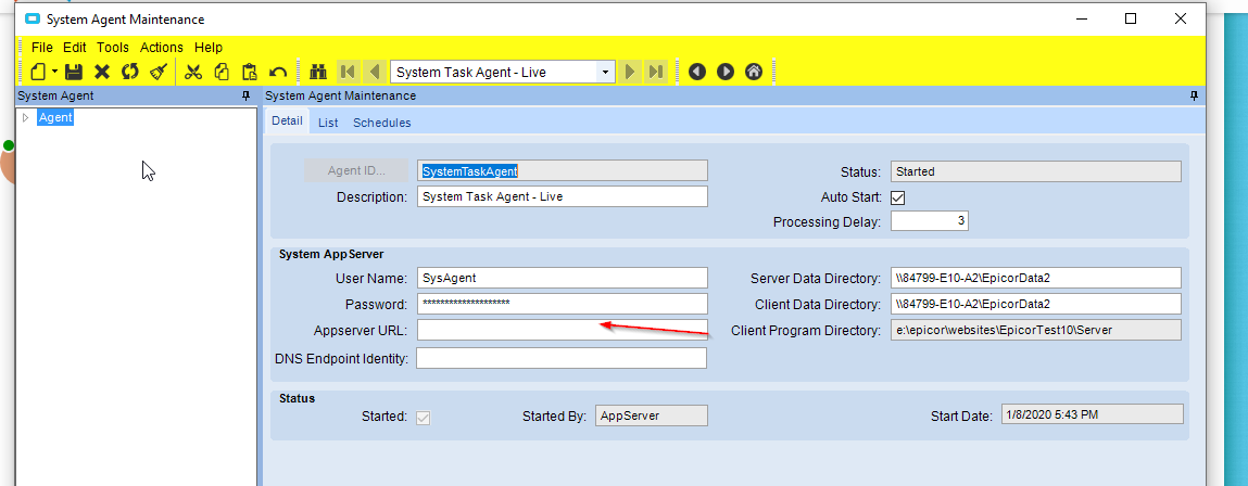

I believe that I’m needing to apply the Application Server URL somewhere within the REST call. But I’m not sure exactly how to do it.

That error seems to indicate a setup issue with System Agent? Looks like it wants the App Server url here
Where would I get the URL?
-Steven Hutcheson
Is just the App Server URL you can get it anywhere the bottom right of Epicor screen, Admin Console anywhere really.
Is just the App Serer URL that the System Agent Connects to, if you want to be 100% certain you can go to the System Agent Configuration Screen on the Server.
Epicor administration console for your app server instance if I am not mistaken.
I don’t believe we have access to the admin console since we’re a cloud customer. I’ll see if we’re able to get the app server URL front there Epicor Saas team.
I’ll try this. Thanks Jose
Is your auto-print set to immediate? Try queued if so. I believe this will resolve your issue.
Auto print works in the client. It’s just not working when we make REST api calls.
I think that the AppServer URL needs to be filled in, but we don’t have access to add it since we’re a cloud account.

Interesting. I ran into this a while ago and have several auto-print setups that works like this (using Rest as trigger). The System Agent URL is not present in all of these which goes from 10.2.300 - 10.2.500 and SaaS. I did notice in your log this part of the message - AutoPrint.SubmitImmediateAutoPrintReport.SubmitImmediateReport - which means it is set to immediate. I do get the same exact error if I switch from queued to immediate. Either way - once the URL is set it works either way.

Yes, this is good to know. The Cloud Team updated our URL but it’s nice to have a no touch solution like this. Thanks @danbedwards.
