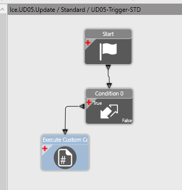

I made a daily shipping notice process that builds an HTML based email of the packer’s contents, previously shipped items , and outstanding items.
It does not include the Packer from SSRS.
It pretty much is all in an Execute Custom Code widget. I’d post the code but I’d have to do a lot of redacting.
okay … here it is
It’s from a DD on UD05 (how I trigger it to run at 4:00 PM each day)
Exec Custom Code

		NewEmailBody = NewEmailBody + "<td>" + OrderRel_iterator.PartNum + "</td>";
		decimal openQty = (OrderRel_iterator.OurReqQty - (OrderRel_iterator.OurJobShippedQty + OrderRel_iterator.OurStockShippedQty));
		sqFormat = (Math.Floor(openQty) == openQty ? "####0" : "####0.00");
		NewEmailBody = NewEmailBody + "<td>" + openQty.ToString(sqFormat) + "</td>";
		//NewEmailBody = NewEmailBody + "<td>" + OrderRel_iterator.ReqDate + "</td>";
		NewEmailBody = NewEmailBody + "</tr>";
if(ff == true)
	NewEmailBody = NewEmailBody + "</table>";
/*********************  Close body HTML ******************/
	NewEmailBody = NewEmailBody + "</pre></body></html>";
// NewEmailBody now contains the HTML for the body
	// setup the email header info
	string Email_from = "no-reply@matcor.com";
	string Email_to = "ckrusen@matcor.com";
	string Email_cc = ccList;
	//  if a PM exists, replace the "TO:" with their email address AND remove them from the "CC:" list
	if(pmEmail.Length > 0) {
		Email_to = pmEmail;
		Email_cc = ccList.Replace(pmEmail+";","");
	/************** Debugging stuff ***************/
	if(callContextClient.CurrentUserId == "manager"){
		NewEmailBody = NewEmailBody + " /************* start debugging info ************/\n";
		NewEmailBody = NewEmailBody + "CC: " + ccList + "\n";
		NewEmailBody = NewEmailBody + " /************* end debugging info **************/\n";
	/*********** End Debugging stuff **************/
	string Email_body = NewEmailBody;
	var from = Email_from;
	var mailer = this.GetMailer(async: true);
	var message = new Ice.Mail.SmtpMail();
	message.SetFrom(from);
		Email_cc = "";
	message.SetTo(Email_to);
	message.SetCC(Email_cc);
	message.SetSubject(Email_subject);
	message.IsBodyHtml = true;  // allows the use of HTML tags
	message.Body = Email_body;
	//message.SetBody(Email_body);  // (this is used for HTML format)
	mailer.Send(message);
	// The following is old debugging stuff.
	// The message was sent a few lines above, so setting these now does nothing.
	body = NewEmailBody + "<br><br>From: " + from;
	body += "<br>To: " + Email_to;
	body += "<br>CC: " + Email_cc;
	body += "<br>Subject: " + Email_subject;
	this.TestBody = "Hello World! (TestBody)";
	this.autoPrintBody = NewEmailBody;
	this.PackNumList = this.PackNumList + ShipHead_iterator.PackNum.ToString() + "~";
this.TestBody = "Hello World! (TestBody outside of foreach loop)";
edit
