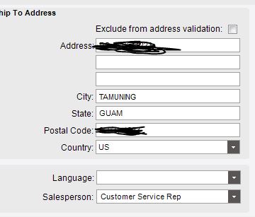

Here are the pics. But we have the address entered correctly in the Customer Ship To Maintenance, but it shows up as 6 lines in the Customer Shipment Entry and my shippers can’t ship with more than 4 lines. Any ideas…

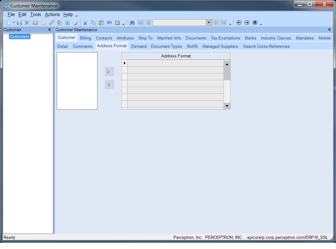

There is a wildly cool feature in Epicor that allows you to control the printout of addresses and it’s called Address Format. You can set the standard on the Country record or override them at the Customer/Ship-To Level
Try it out.

Are you changing the Customer or the Ship-To Address?
I’m in Customer Entry–>Ship To–>Selected the ship to customer–>Address Format.

Adding to what Mark stated, you can put the city, state and zip all on one
line by stacking the fields next to each in the format line area. In your
picture it looks like you still have each of these on their own line.

Well, I got it to work by crook. I did what @BoostERP said and stacked the lines. But still have the US at the 6th line and can’t delete it. Shipping said it still won’t let them print the label with the US being on the 6th line.
@Mark_Wonsil I see what you are saying now. I’ll get that up in a bit.
@BoostERP All I needed to do was hit the delete button. LOL! It’s been a long day. Got it to work. But need to figure out why it won’t work any other way. IS there a listing of what is state side shipping vs international? Wondering if we have Guam as an international and not state side.
Guam uses the US format. If you feel zealous, you can find all address formats here:
and then set the Country codes up with the format. As you enter new customers, they will use the format of the country. If an address is strange, you can override at the Customer level. This requires some standardization of address entry1 Line one should ALWAYS be the same - street address for example. Line Two, always apt/suite, etc.
