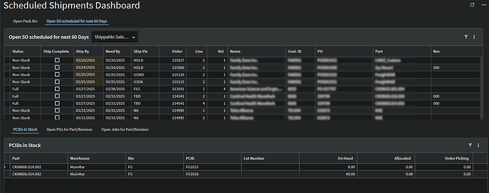

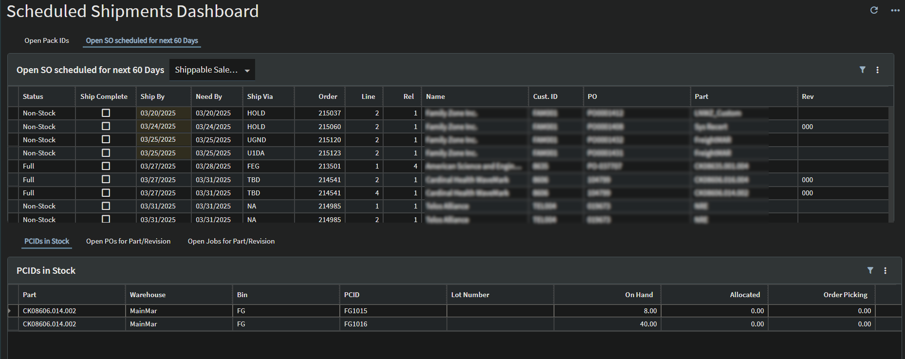

We don’t do loads, just individual customer shipments, but we find that receiving jobs into inventory as PCIDs makes customer shipment easier. We have a dashboard of pending shipments for the site and SO releases scheduled to ship. A detail pane shows available PCIDs in stock as well as non-PCID stock available to ship for that release.

Here is a screenshot of the shipping dashboard.

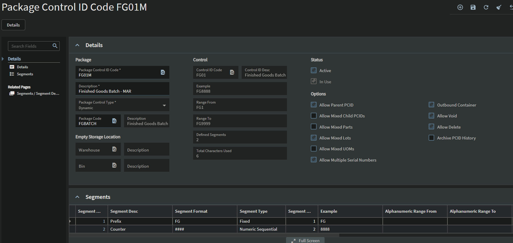

On the last job operation, we do not auto-receive into inventory. This allows us in MES to generate a new PCID and place the produced assembly into that PCID. Then we do a Job Rcpt to Inventory and just move that PCID to a finished good stock area.
Below is our PCID template. These are dynamic PCIDs since they are only temporary - they “go away” after the PCID is shipped. And since these are for individual job outputs we don’t allow mixed parts. But you can also see how it is an option to allow child PCIDs inside of other PCIDs, and to allow mixed parts, s/n’s, lots.
The PCID counter in this case is only 4 digits, and for our site the range FG1001-FG1999 is available. Another site might have FG2001-FG2999. Once the last PCID# is reached (‘FG1999’) for our site, it then loops back around starts at FG1001. Since we are low-volume, 999 PCIDs are more than enough per site to not be concerned about overlap due to looping around. Other companies might choose more digits or more segment in their schemes.
