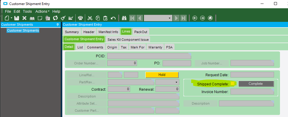

In Customer Shipment entry, you can check the “Shipped Complete” checkbox on the shipment and it will close the line/release short.

So if remaining qty is 8.00 or less, we would want that shipped complete checkbox to be checked
If the person in shipping knows they are short shipping an order line they can mark the line complete in shipment entry. Otherwise they can look at the Epicor sales order backlog dashboard that shows open lines with backlog open amounts
