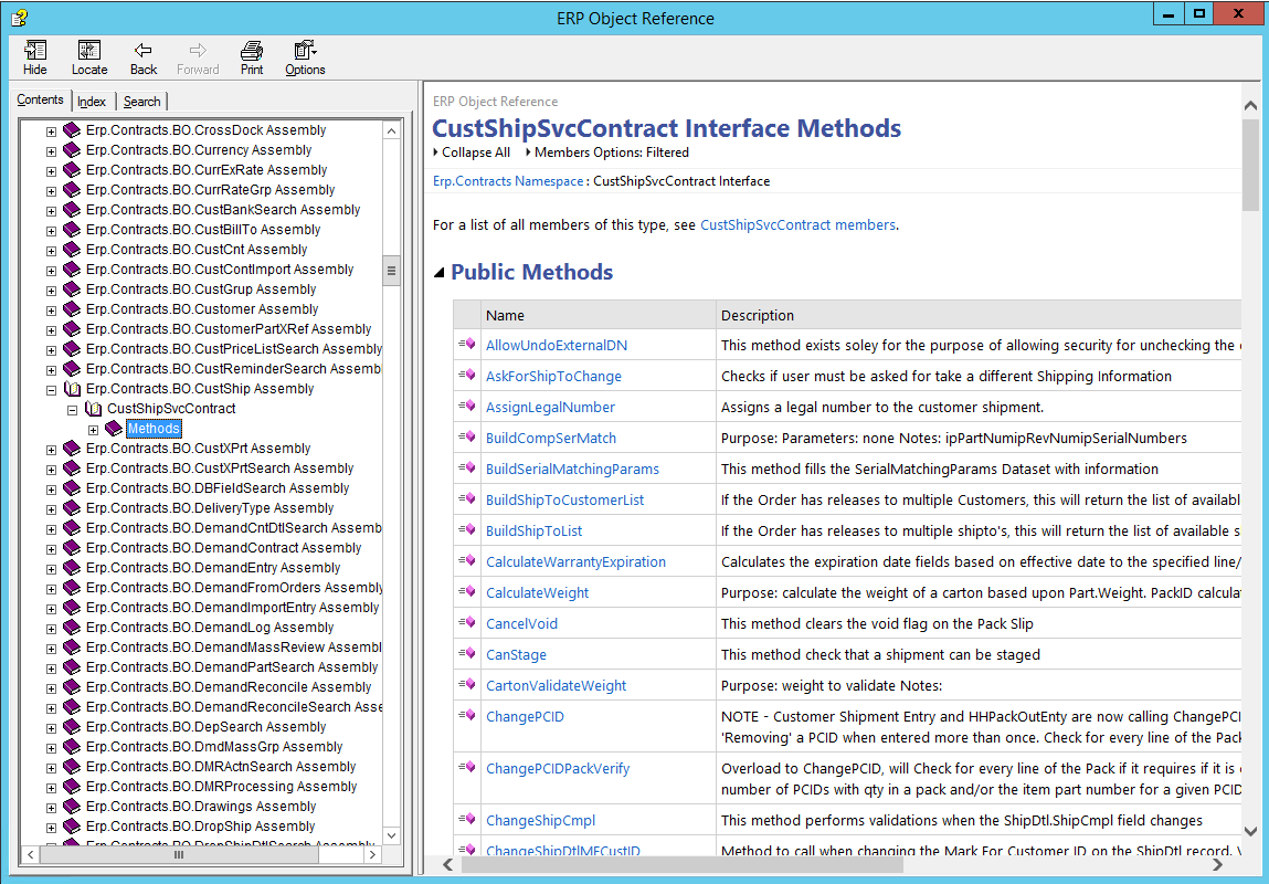

Hi William,
If you log on to Epicweb > Documentation > Product > Epicor 10, then go to your version > Technical Reference, there is a zip file ERP_BO_Ref.zip. It has a 30mb chm file which provides and MSDN-style reference to the business object assemblies (and a few ICE ones).
Here is a sample image:
