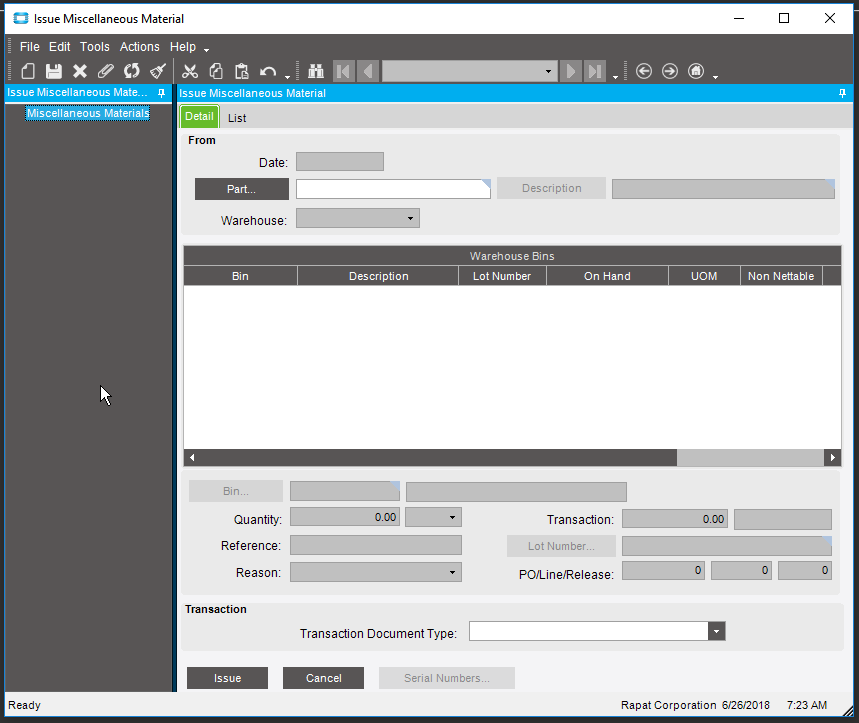

And there is one more tool I forgot about, Issue Miscellaneous material. Again, I don’t recommend keeping close tabs on low value items, but for discretionary use high value items, you can do a miscellaneous issue instead of a quantity adjustment. They use the same reason codes, so I would imagine they will hit the same GL accounts, so accounting wise, it probably doesn’t make a difference, but for keeping track of why they change happened, it might.
