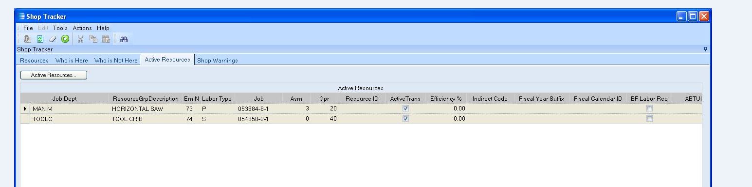

Is there a way to clear out orphaned Active Resources showing up in Shop Tracker. These 2 jobs are already closed, but I see no way of clearing them out of the shop tracker view.
Any Help would be greatly appreciated!

The official way is to run Conversion 8920 End Activity on labor Detail Transactions. This will uncheck the Active Trans checkbox.
I made an updateable dashboard ( attached ) because at one point I had several each day.
Greg

Thanks, Greg
I ran the conversion program and it did let me set those resources to non active.
Thanks for the dashboard, I did try to import it on my test database, but it was complaining about a missing BAQ.
Thank you for the help!
