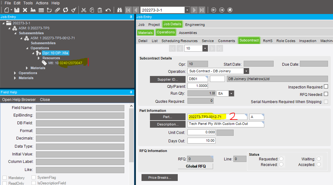

I would like to know how to create a report which shows the related material of a subcontract operation on a packing list.
The standard SSRS report shows the part that the subcontract operation is ending up as, but we need the related material to show on the picking list report. I know how to edit reports but not sure how to get to the related material table.
