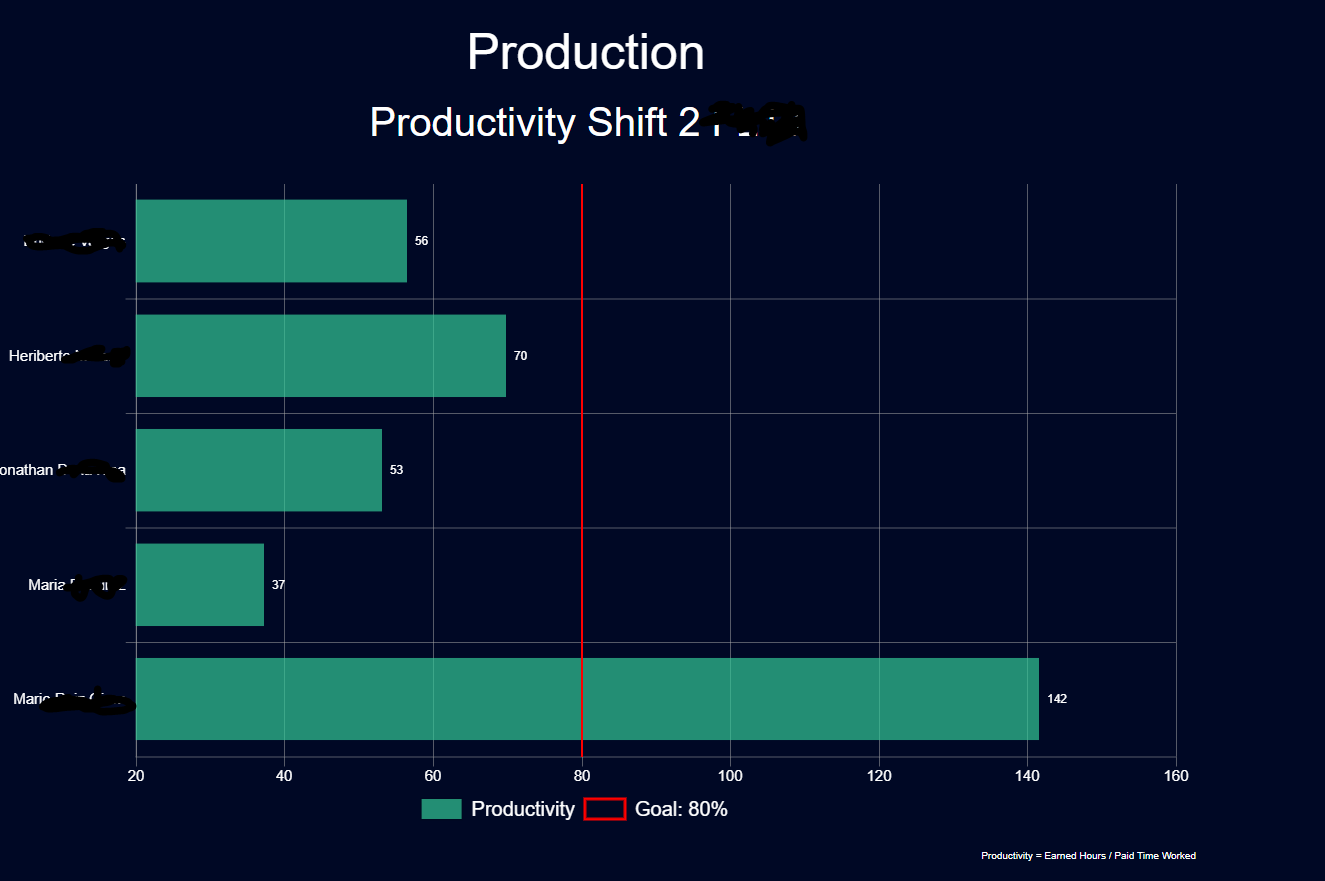

[ Showcase ] Epicor Customizations to the EXTREME w/ CEFSharp
You heard about Epicor Customizations to the MAX. Have you heard about Epicor Customizations to the EXTREME.
JUST FOR THE RECORD: I would probably not build Dashboards like this anymore, I can directly just use REST Nowadays and maybe use CEFSharp as a Wrapper to add more interaction. It has other USE Cases. BUT, Epicor is working on something like this to make things easier to develop! #woot.

Yeah, I agree. For me is also easier Web Development (for the record, I learned everything from the internet, I am an industrial engineer). With REST and Javascript I created a very decent looking (matter of opinion I guess) dashboard that has several slides with different metrics and stuff.
Niceee!!! Now you can get CEFSharp (Chrome Rendering) or Just use Microsofts WinForms WebView (Explorer Rendering Engine) which always has its Quirks and add it to a Tab on an Entry Screen or Dashboard in Epicor and it will show-up =)
