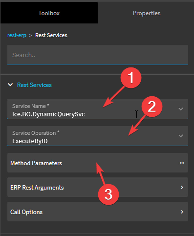

So, I think I mentioned this in another thread, but I sidestepped this issue by hiding the original grid, adding my own, then loading it with data via the rest-erp action and the Erp.BO.DynamicQuerySvc.executeById method.
  1. Add a rest-erp action to an event. Hook the event to whatever you want.
  2. In the action’s properties, specify the service name as Ico.BO.DynamicQuerySvc, the service operation as ExecuteByID.
  3. Click into Method Parameters. For the queryID parameter, specify the ID of your BAQ in the Field Value field.
    In the executionParams field, specify your BAQ parameters using a JSON object…

ParameterID is the ID of the parameter from the BAQ parameter editor. ParameterValue contains the actual parameter value. You can interpolate dataview values here with the {} syntax. Since parameter values are sent as strings, ValueType can be used to specify otherwise. If the value is truly empty, IsEmpty can be used. This is important when triggering the Skip Condition If Empty BAQ parameter setting.
The rest-erp response from the executeByID method returns a JSON object of the format

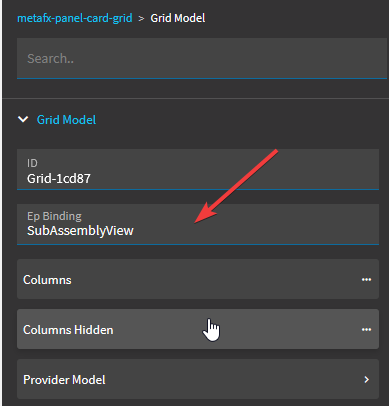

This should result in the data from your BAQ successfully loading into your dataview. The next step is binding your dataview to your grid and (probably?) defining columns.
  1. On your grid’s properties, specify the view name in the Grid ModelEp Binding field.

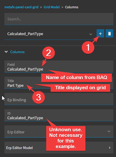

  2. Under Grid ModelColumns, add columns to the collection that you’d like displayed on the grid. Set the Field property to the column name from your BAQ. The Title property is used to set what text is displayed in the column’s header.
