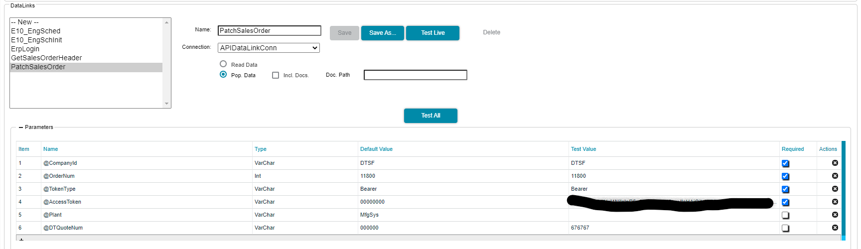

I have been attempting to get the syntax nailed to update one ERP Table field in a json datalink file (learning this as I go, don’t know all the proper terms). I have been able to get the “ErpLogin” and “GetSalesOrderHeader” working below but no luck with the “PatchSalesOrder”.

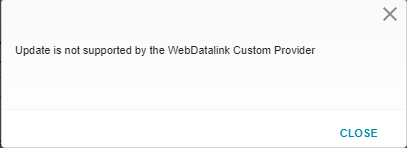

The error I get is during the Test Live is:
All parameters set to test values in ECM Admin DataLink Manager

Can someone chime in to shed some light on what I am missing?

I am not even getting a Log file out of this like I do on the others.
