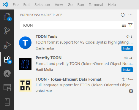

looks like a few bleeding-edge vscode extensions are up.
