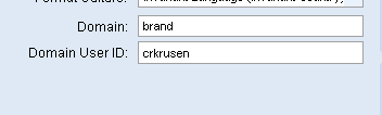

We have pseudo SSO by using an endpoint binding of “Windows”.
This works by using the user and domain info of who is logged into the client computer, and automatically selects the E10 user account whose domain and Domain User ID.
So launching the client on a computer will always make that session us the E10 user based on who logged into the client computer.
Our remote users use RDS, which logins them in using their domain credentials, then passes the user name on to the E10 Client.
