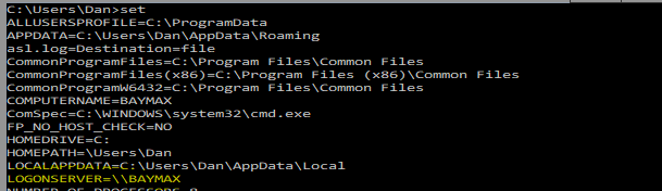

Correct, it will use Windows to determine this. You can run set from a command prompt to see what domain controller you are using. Look for the LOGONSERVER entry. Also, check DNS on the server and workstation to make sure they are correct for your environment.
