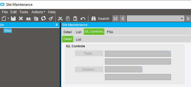

If you have configured COA with site / division as one of the control segment.
Then you can map the division GL control code in the site maintenance

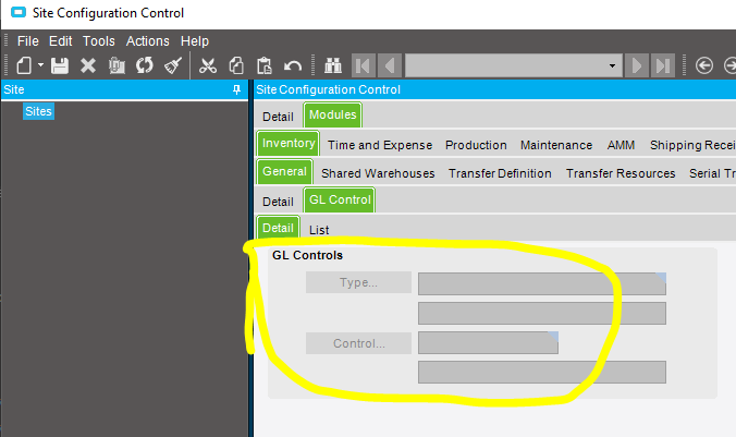

Try mapping the GL control code of “Inventory COS and WIP” in the site configuration.
If control type is not available, same need to be enabled first from the GL control type maintenance.
Create Inventory COS and WIP GL Control Code for each site and map them in the site configuration.

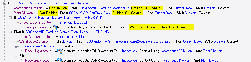

I looked into the GL Rules for COSandWIP.
A transaction like PUR-STK (Posts Extended Cost to A/P Clearing and Inventory/Expense Accounts. ) has rules that determine the division for the “inventory”(or expense) side of the transaction:

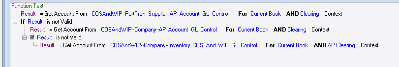

But when determining the AP Clearing, the function Determine AP Clearing Account For PartTran Line is called:
The entire function is:
So maybe make a new function Determine AP Clearing Account For PartTran Line with Div, and add the the logic to retrieve the Division. Then update the Booking rules (tran types) that need to use this.
FWIW - I would not personally try to edit Booking Rules . Seems like way to many ways for things to go sideways.

Thanks, Calvin. This is what I did for the first half (receipt side) and it works.
The second half that picks up the AP invoice is where I am having some some challenges. It looks like a similar approach with a custom function/variable but I was hoping somebody had done something already.
