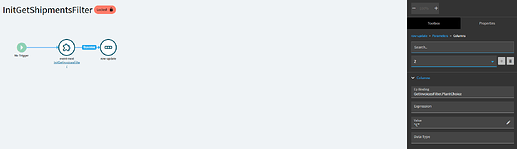

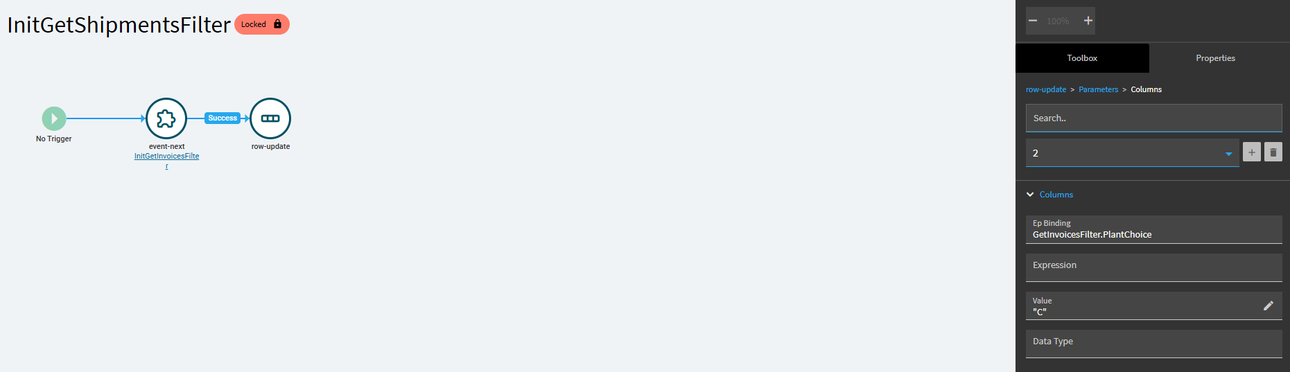

The filter for that combobox is set via event when the GetShipmentsTool is clicked.
One of the row updates in that event is setting the value of the GetInvoicesFilter.PlantChoice to a value of “C” (Current).
You can change this, if you want to customize.

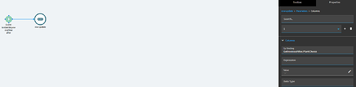

Just add a custom event to run AFTER the above event that performs a row update to set that GetInvoicesFilter.PlantChoice to a value of “A” (All).
That new row-update will take effect before the slider opens.
