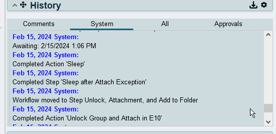

Are there any “Unwritten rules” for this sleep task? When trying to attach to an invoice, for some reason, if the group is locked, it errors out. (why? I don’t know, that’s another question). But you can retry once there isn’t a user in the group and it works fine. So I figured I could just put a sleep and retry loop in there. Now that we’re hooked up to live, I don’t really have a way to test, so I wired it up and waited for the issue to happen.
Sure enough, I had some today. Sweet, I’ll wait a bit and see what happens.
I can see in the history that it retried, but it failed again.
Now, I can’t at this point 100% rule out that it wasn’t still a timing issue, and someone had their grubby little hands in the group. However, whenever I hit the await button manually, it completes. I’ve never actually had one not work when doing it manually come to think of it.
As I typed this, I realize that the screen shot that I took on this one was more than 1/2 hour later, and it should have tried again by this time.
