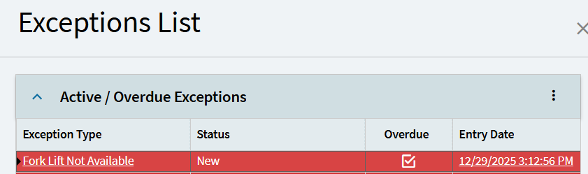

So I have a grid which I’ve set one column as a link and got that to work, now, when i click that link I want to slide out another app to show the details for that specified row for the link I clicked

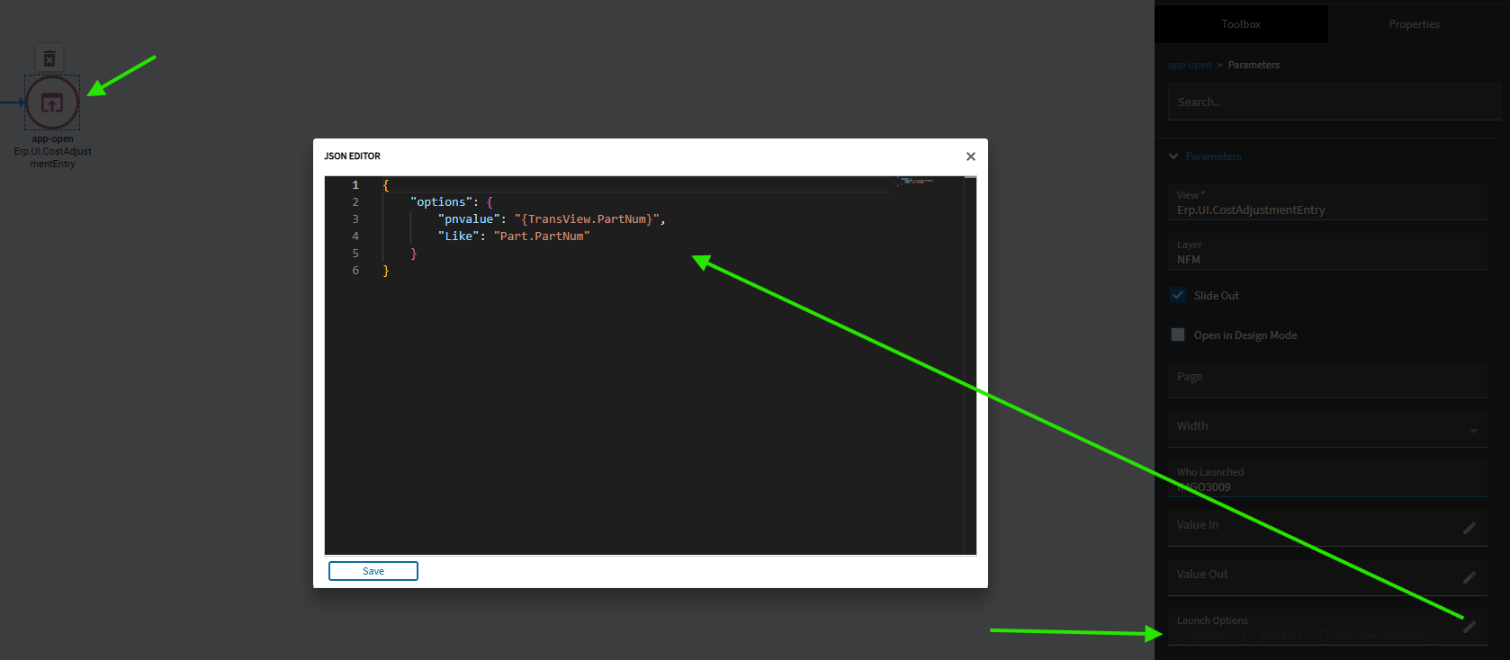

This app-open event will need some json in the “Launch Options” parameter. Below is an example:

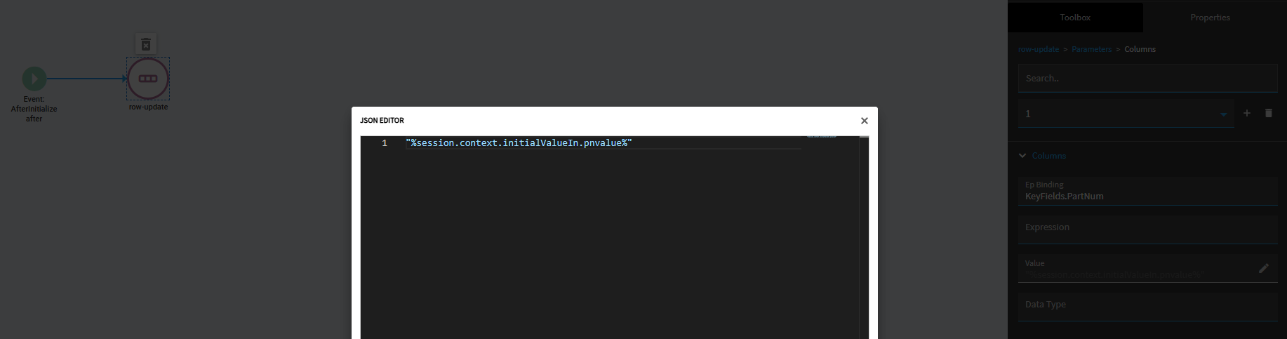

Again, you just need a row update with a value expression:

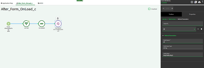

So I was able to get the info over. but now I’m wondering how to use that to select the row with matching data.

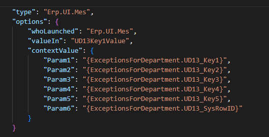

This was how i did the json in the app open module’s launch options:

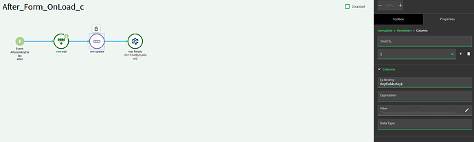

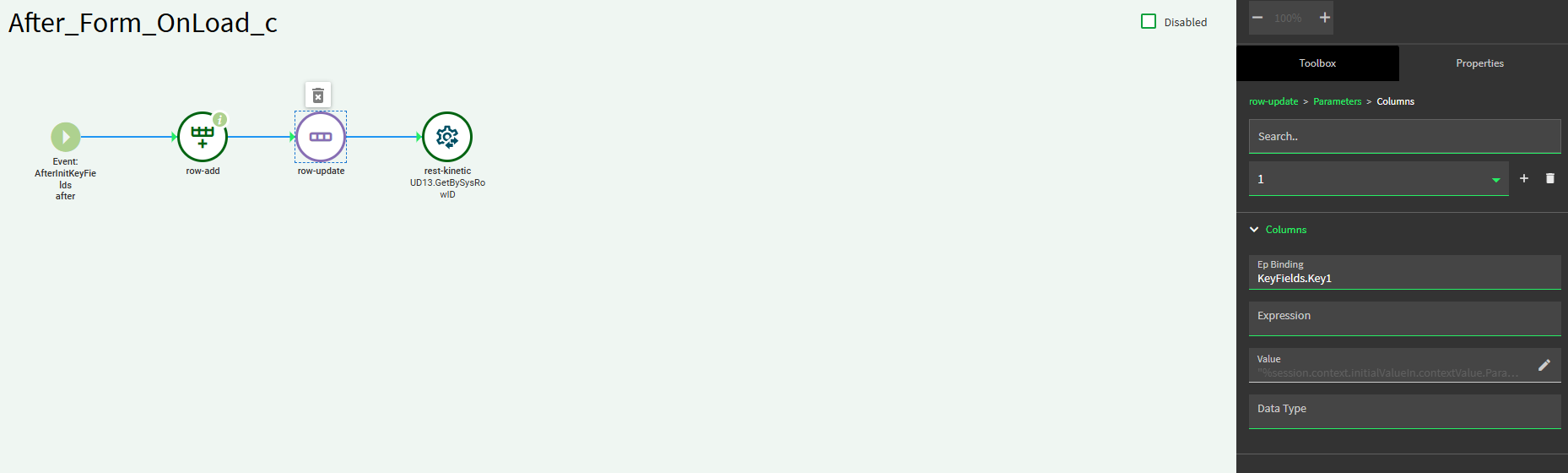

Then I figured Id apply that transfered data to keyfields

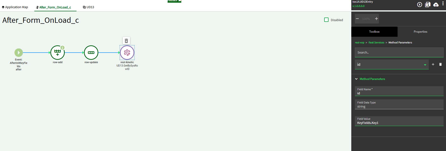

then i tried to do a rest kinetic module to call the GetBySysID…but i have literally no idea how all that works of what/how i use it to populate the details screen :joy:
Are you truly want to add a new row in the second app? is this creating a new UD13 entry? or are you looking them up?
I feel like you’re using them to look up an existing UD13 record (based on your rest widget at the end of that event).
that row add is for something else. its creating a transview element for separate functionality. Goal with everything after that row add is to find the row that has the same sysrowID we are passing from the previous app and populate the details with it
I might make the row-add a different event. let this one focus on pulling up the correct record.
Since you’re passing over the SysRowID in Param6, that really might be all you need.
So, for testing sake, just use the row-update to set TransView.SysRowID to the value of: “%session.context.initialValueIn.contextValue.Param6%”
Test and see if that sets TransView.SysRowID to the correct value.
If that works, you can add to that event to do your rest-kinetic. That SysRowID is the only thing you need to pass to that method and that will pull the resulting matching record into… whatever dataview you’re trying to use (assuming it is a UD13 dataview?).
