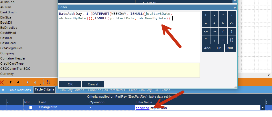

If it’s the between that you’re having a problem with, you’ll have to split it up into 2 rows and use a >= and <= with an expression in each one.

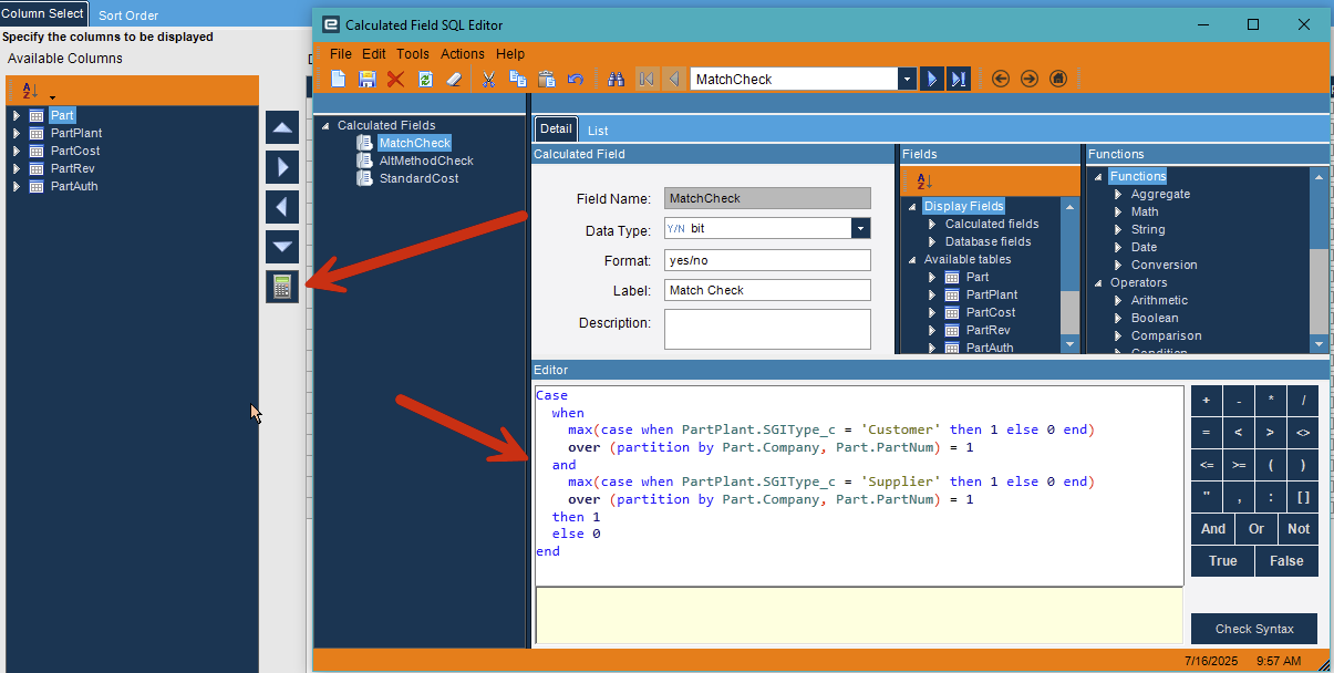

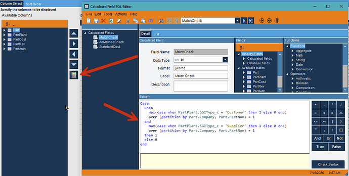

Or if you don’t know where the calculated field button it, it’s here. Then you can put in the same code that you have in your SQL query.
