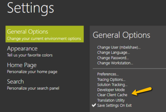

I would try clearing the client cache first:
If that fails you can try to clear personalisations but you will have some work in setting screen layouts again.
I tried clearing the cache, as well as the C:\ProgramData\Epicor\server-808 folder, neither of which helped.

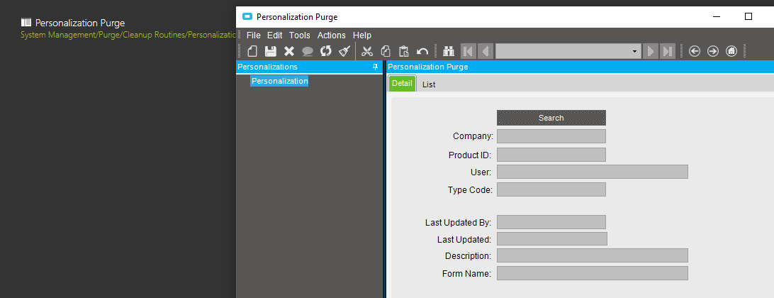

But, you mentioned clearing the personalization’s…is there a way to clear all personalizations for a user?
Yes, it’s called personalization purge. I can’t believe I hadn’t mentioned this yet.
You can search by user and then select certain personalizations and purge them or select all and purge them.
I had an issue like this a couple weeks ago and this fixed it.
