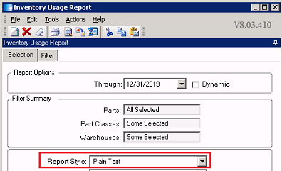

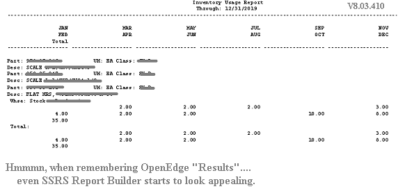

NO, as far as I know the only thing even close in V8 is the inventory usage report that you might be able to find slow moving items with. But it is pretty hard to work with, one of those old Progress “Text” style reports that can’t be modified. i.e. why you’re probably looking at Crystal, ODBC and/or adding SQL view(s).
Yes, when not well defined up front… expect endless rework.
At least it was easy to tell if it was not customizable. I’d ask the user, “does it look like it was printed on a typewriter?”
(Not everyone knows what a monospaced font is)
