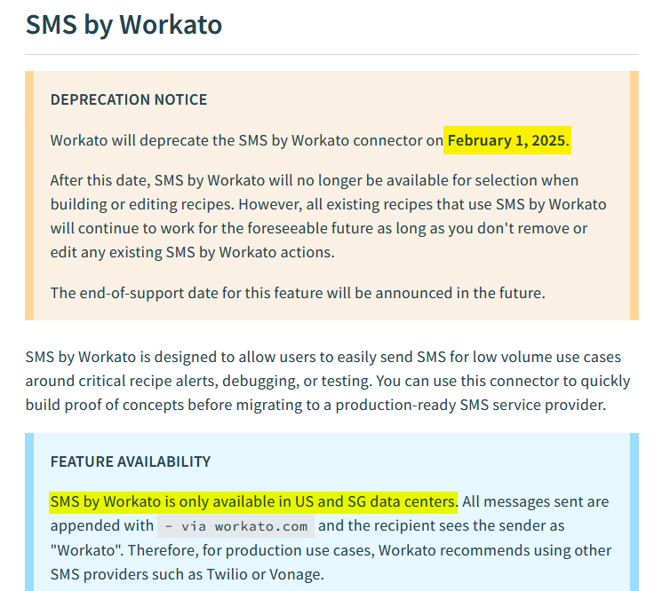

I feel Workato is a no-go, deprecated and we’re not in the US.
And Twilio?
