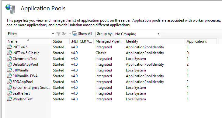

Can you share the IIS Application Pool Advanced Settings for the “Main” and “Test” application servers?
it does not exist. We get this error on trying manually enter a SO and using DMT to enter new SO’s.
is this what you are looking for??

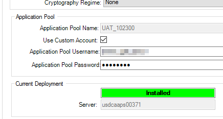

Do you use the same Server Data Directory (a setting in the System Agent) for both your main and the TEST Apps?
Replace LocalSystem account you use for pool with some active directory account
Run “Generate PO suggestions” (or anything that generates a log file).
Does that work? If it doesn’t, then it is something preventing the App from writing to it. Does the TEST App configuration use the same user and password as the production App?

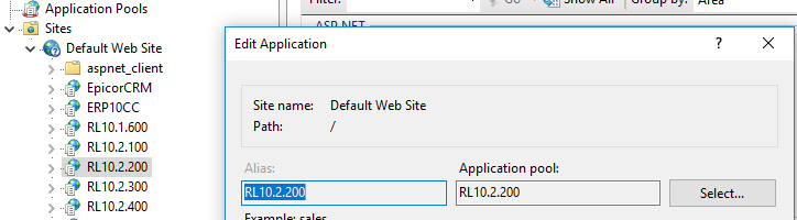

So which pool is the one working and which “test” one is not?
If you expand Sites you should be able to see which pool is used for each site.
Check the differences between the instance working and the one that doesn’t.
