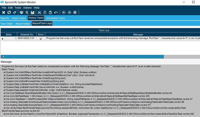

We have encountered an error this morning so SO picklist not printing and error says something to do with hexadecimal value. Screen shot below. We are still using Crystal forms. Can someone help, please?

I think I figured out whatβs causing this one now.
Did a BAQ and filtered the linedesc to Like β%β + CHAR(0x1f) + β%β and it gave me the SO number that needs checking. Pasted the line desc in Notepad++ and just deleted the extra chars.
