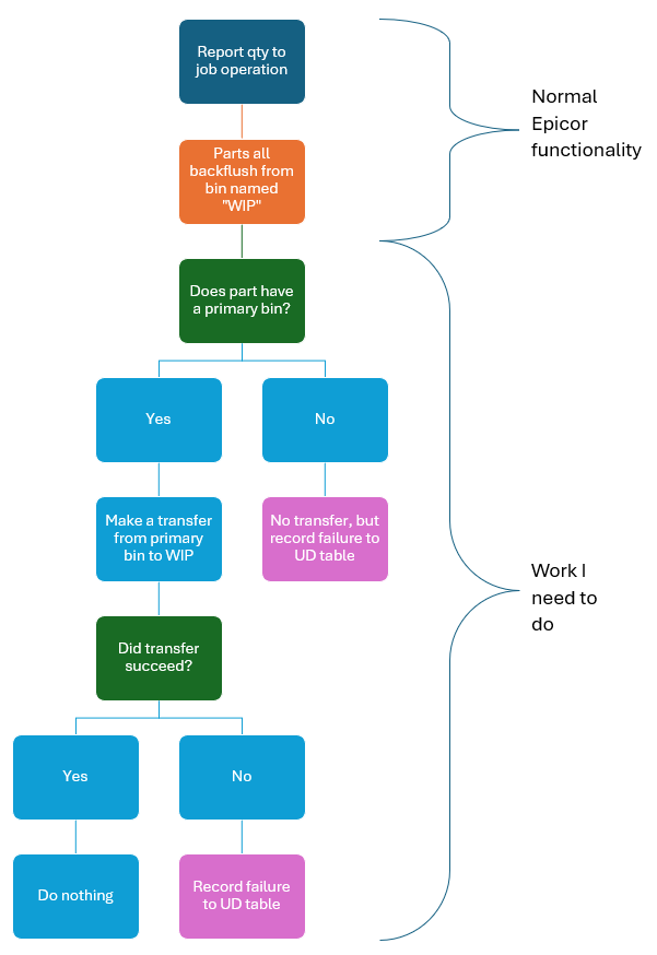

Problem: I want to override/supplement the backflush logic for parts on a job.
Flow would be like this:
Thus (I think that) I need to:
# Task How to do it (maybe)
1 Find the part’s primary bin (in the MFG warehouse) SomeBO.GetByID
2 Determine if that has a value Condition block
3 If no, log to table EFx
4 If yes, do an inventory transfer EFx
5 Did transfer succeed Not entirely sure…
6 If no, log to table EFx
And so I would string that together in another Function, triggered by a BPM on… something.
So how would you implement the workflow logic? Especially #5, the error handling; I think that has the most relevance to the video, for example.
