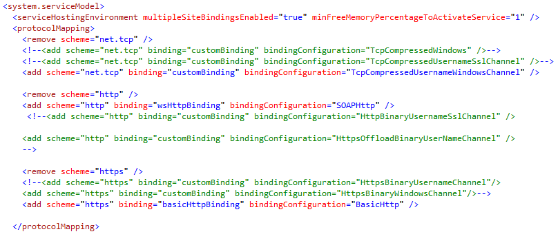

Are you standing up the SOAP 1.2 binding in Web.config? NOTE - Integration APIs (Basic, soap 1.2, etc) are not in the Admin Console UI so you need to manually edit them.
